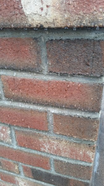

    heavy rain today,was on the roof clearing gutters......water sure does roll off chimney when waterproofed properly 20161021_145702.jpg

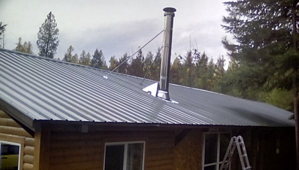

    Got up on the roof and added the top section (3 ft) and the snow divider, and resealed around it as I got a little dripping in the heavy rains of a few days ago.
    I also sealed the vertical seams of the chimney (per the Duraplus instructions, which I ignored :doh: the first time aroound). I think the seam was the point of water entry.
    The new chimney looks good on the new roof, if I say so myself, and I just did.

    Let us know how the draft goes now

    Did you have those supports on there before

    Yes I did, they attached to the top of the 2nd section. If I were installing them now, I would have anchored them a little higher on the roof to give it a flatter angle, but it's not worth making more holes in the roof to move them.

    I was wondering because it didn't look like you needed it before you added that piece

    It was likely overkill before.
    Looking at the photo, I am wondering it I got the chimney vertical? I didn't put the level on it, so it may be off, but it looks OK, except on the photo. (It's hard to tell with all the angles.) I got a little rushed at the end, needed to get a couple of other things done. I'll go up there with the level tomorrow and tweak it if needed.

    Judging from the pics of the secondaries posted in another thread, I'd be willing to bet he didn't need the extra length.
    Job looks good!
