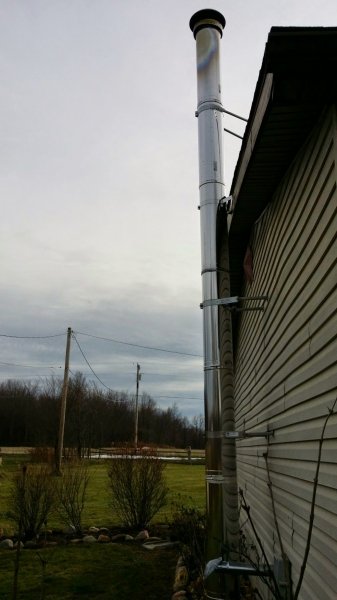

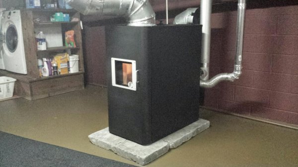

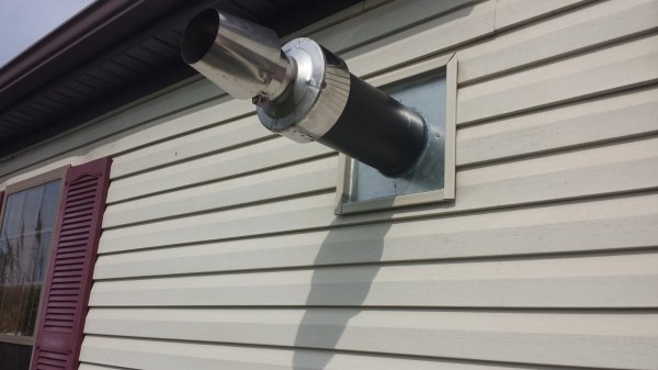

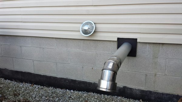

    Here is my flues..
    The wood stove and chimney/flue..
    The pellet stove upstairs and vent..
    The pellet furnace downstairs and vent..
    All have OAK's!! ;)

    Wow nice setup. Love the basement. In pick #2 I see your chimney is discolored? Mine looked a little like that last winter. I got a little scared I was over heating it. Is it something I should worry about? Thank you for the information.

    It is actually from oils in the creosote washing off your cap...it shows on the shiny stainless

    So maybe my wood was a little to wet? When I cleaned the chimney I barely got anything out of it,

    No not necessarily, even with dry wood it seems like you will get a little buildup on the cap (unless you run the stove pretty hard a lot) and that is enough to get a little streak like that going on after rain/snow, etc

    Also, SS will discolor like that from heat. Chief

    That's true, it will. Do you see something there that makes you believe it has burnt?
    I have seen that "top down" discoloration/staining on numerous chimneys (including mine) that have never been overfired. I really doubt that normal operation would be enough to discolor because you can lay your hand on the bottom of a class A chimney, even when the stove is crankin...and the top will be even cooler. And although it is certainly possible, I suspect Thors chimney has not been heat discolored.

    You are probably right. However, some SS discolors pretty easily. I have 2 SS chimney caps and one of them is dicolored like that and it has never been over fired. Just throwing that out there as a possibility and nothing to worry about. Chief

    Mine is not like that now, maybe it washed off from rain. I just thought I may have heated it up to much. Thank you all for your help!

    Mine gets like that and the rain gets it off. My cap right now is clean and shiny on the inside and outside, and I haven't cleaned it yet. Rain works wonders.

    Of course if it washes off it is not discoloration of the SS. So sounds like you are good to go.

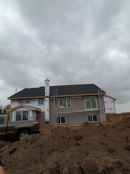

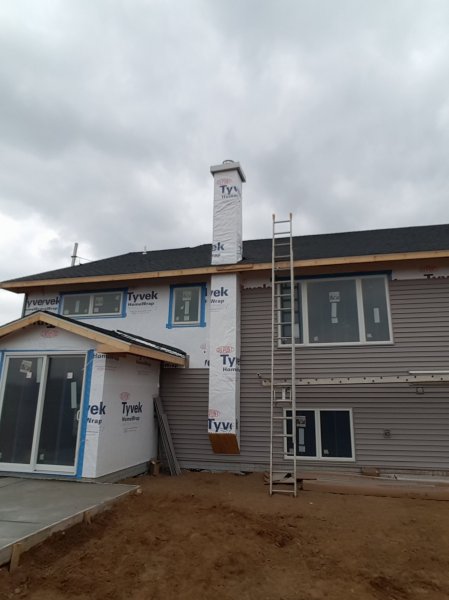

    Here it is with the chase top on and the cap!
    Can't wait to get the IS hooked up to this system! Seems like :makeitrain"in the wind right now. I will have about $6,000 into this whole "free heat" system with the IS stove, chimney (cap, 20 ft SS, a T, and interior double wall,), the chase, chase cap, and extra work of siding!:whistle: Thank goodness for CASH or this would have probably been pushing $8,000+ for what the builder wanted to charge me. Got a friend of my dad to build the chase and a friend of a friend to get the chimney pipe (ICC Excell) and install it.
    From my calculations I'll start seeing a payback (actually start saving $) in the 5th season! Figuring that off a $200/month heating bill for about 2800-3000 sq ft. Probably wouldn't be that high though. Man I better stay living here for awhile......
