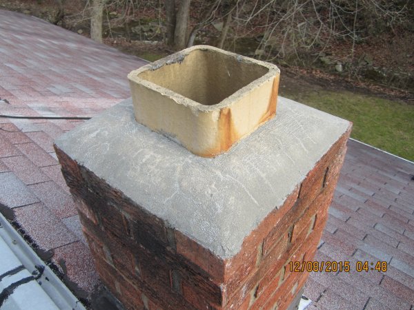

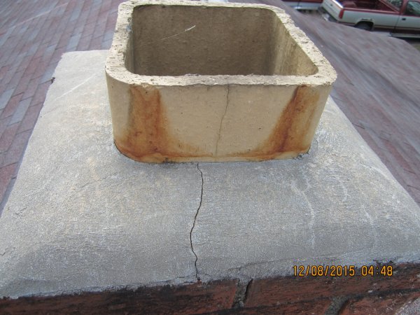

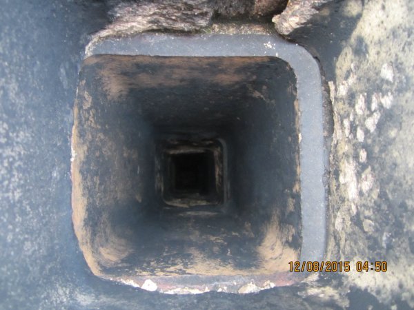

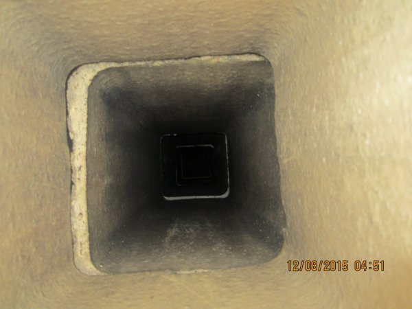

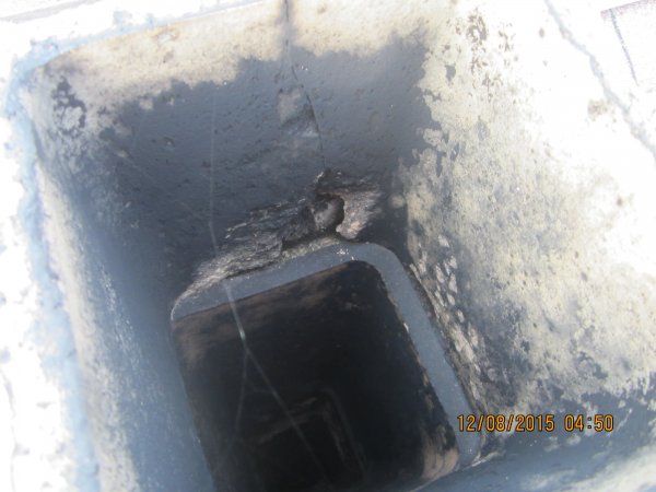

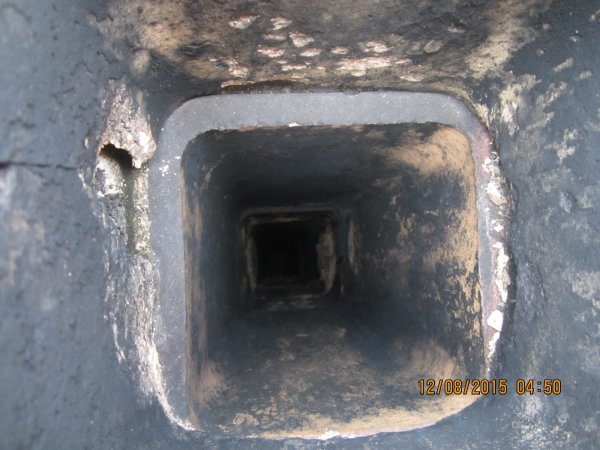

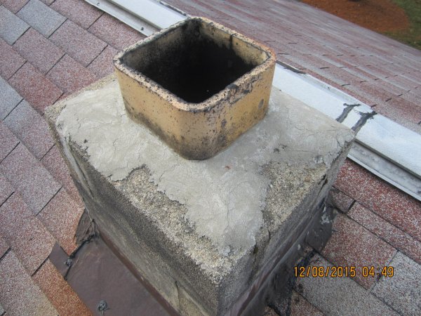

    This is my set-up...well, it was my grandpa's set-up...
    In place 40+ years (edit...correction...41 years...1977-78)...smoke dragon stove often burn low, but with dry...dry wood, 6" pipe from stove to 8"clay. (This is not to say clay is better...rather that often factors play a big part and every scenario and situation is different. There are some issues as can be seen...but it's worked just fine for a long time and very likely has many years left ...40+ years and no cap...probably should have one.)
    I'd say 6" to 8" air flow is pretty good on this set-up. Would it look even better having been 6" all the way out...maybe...but not sure it would be noticeable. That said, for optimum draft...it should have been the same size all the way to the top. Then again...a tad oversized allows me to change stoves whenever I want.
    Lots of things going wrong with this chimney above and some things that I would do different, but lots of things to take note of as well. As I said, there are some issues. That I can see with a strong light and a big mirror...I can only see two cracked liners...one at the top, one above the thimble. I will admit it would be interesting to have a camera ran down its gullet...but over all I am thoroughly impressed. Pap never believed in a cap...these days they do. He always said you didn't need it other than keeping out moisture when not in use. Said he always meant to cover it each spring, just never did. However, he was adamant about not having a cap when it was in operation. I don't agree...but one has to admit he and the old timers he mimicked were on to something. Then again, every scenario is different.

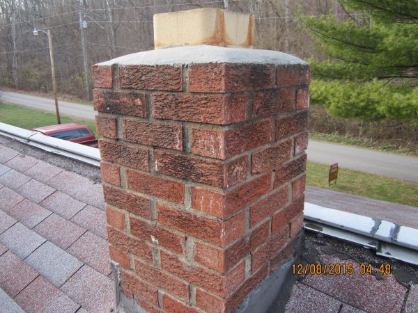

    For comparison here's my other set-up...under one roof...1969. Guess what's burned in this one?
    Note the 4" solid block on this one. The brick one I believe also has 4" solid black wrapped in brick...I think. New roof has been installed, but I should have done some work to both of these first. Bad mistake on my part.

    I thought you said you had a good clay liner. Neither of the chimneys you posted have anywhere near a good liner. Both should be relined with a proper insulated stainless liner
    Horkn and brenndatomu like this.

    No. If you go back and re-read what I said just a few posts above about my own liner, you’ll see no less than two times that I mentioned there were issues with my liner. No need for me to quote them. If you hadn’t already seen what I said the first time you probably won’t get it a second time. The information is there. Read it. I think I was pretty straight forward with what I said about my own chimneys.
    About my own chimneys pictured above...again...I said I should have done some work on both of them before putting on a new roof. I will also tell you I’m not scared of them as they are either. I will work on them when I get ready.
    I said I wouldn’t remove a good clay liner. I never said mine was good...I said at least twice maybe more that mine had issues...but even with those issues it’s been working and I’m not scared of it.
