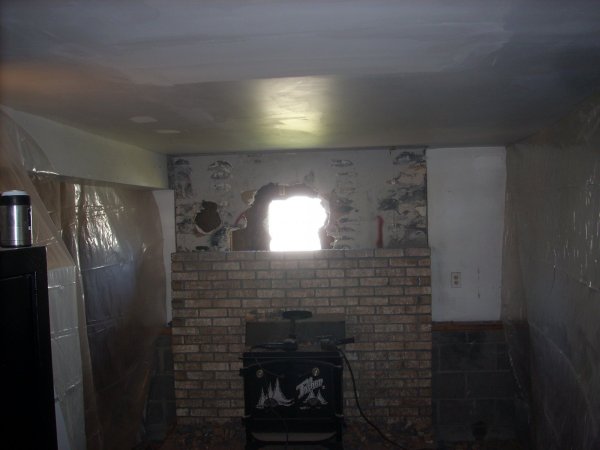

  4. WeldrDave
    10,181
    56,131
    I got to the height I needed! My 59 year old arms are a bit tired! fishingpol , yes throwing what bricks I can out the hole. I have just as much in as I do out though from fragmenting when breaking. I gotta start cleaning up now! Deserve a Beer now! I took a flying fragment in the lip and it's feels (JUST WONDERFUL). :headbang: :drunk::coldone: The sheet rock behind brick was also wet. Not real bad, but it was. It all has to get cut out now, I'm gonna worry about that another day...

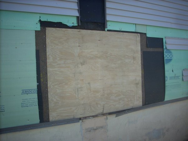

  10. WeldrDave
    10,181
    56,131

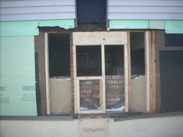

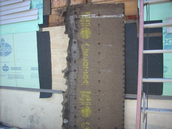

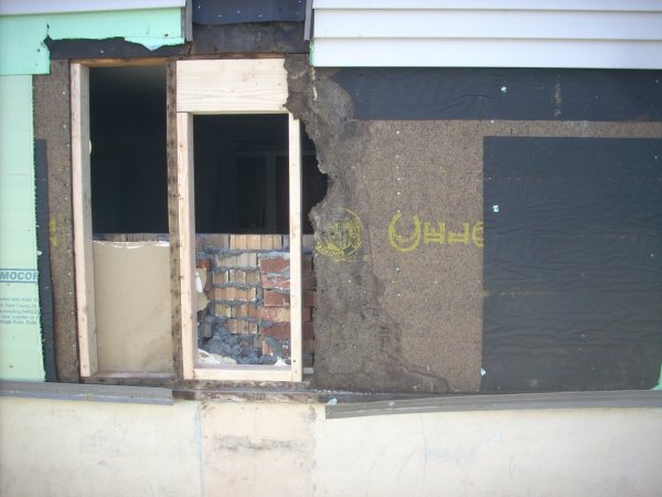

    Today I tore everything out that was bad, rebuild the wall and made a header assembly for the new pipe thimble that will go through the wall. My Buddy, who installed wood stoves for a living stopped by and gave me some "rough" measurements to have built in so when we get ready to install the pipe. Gott'er buttoned up today, going to put some tar paper up for the night. Well, one floor done now gotta move up to the second tomorrow... Motrin & Beer time, in that order. :drunk:

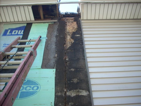

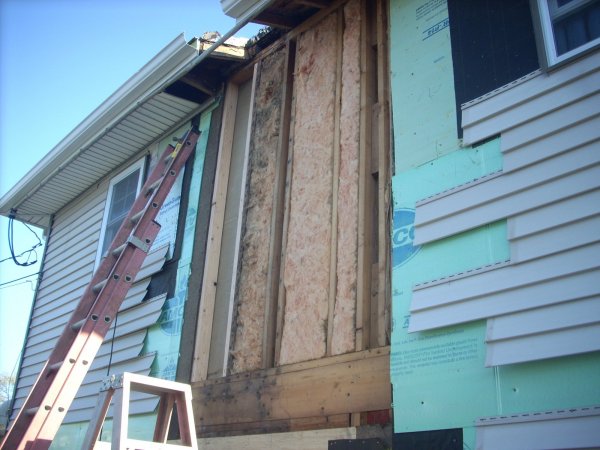

  12. WeldrDave
    10,181
    56,131

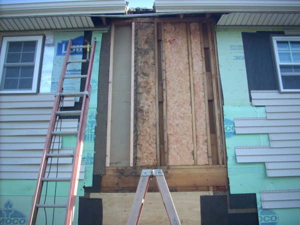

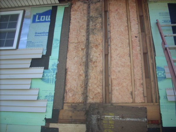

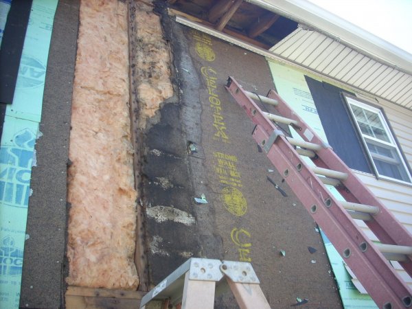

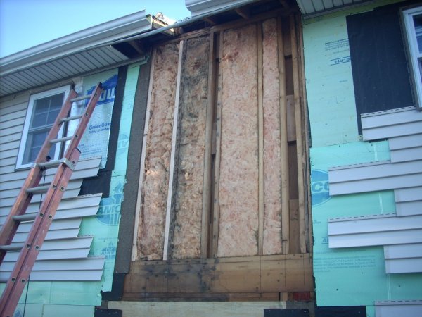

    Yesterday was a Looooong day. Worked till dark. I got the wall torn apart, siding down and all the bad stuff cut out. I had to sister 2 studs in, one only for a nailer but the other stud was (Iffy) at best. Today I Hope to get the sheathing on and tar paper on. We're supposed to have light showers later today, I'm only a one man band here doing this myself and climbing up and down that latter all day is kicking my A$$!!! :pain: Enjoy the pics. :ithappened:
    DSCN4490.JPG DSCN4492.JPG DSCN4496.JPG DSCN4498.JPG DSCN4499.JPG DSCN4500.JPG DSCN4503.JPG DSCN4504.JPG

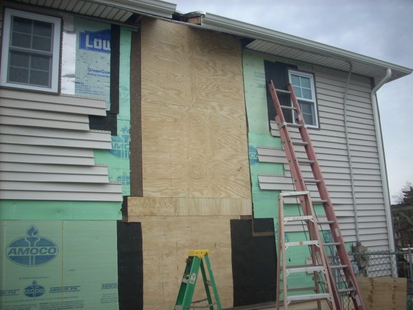

  16. WeldrDave
    10,181
    56,131

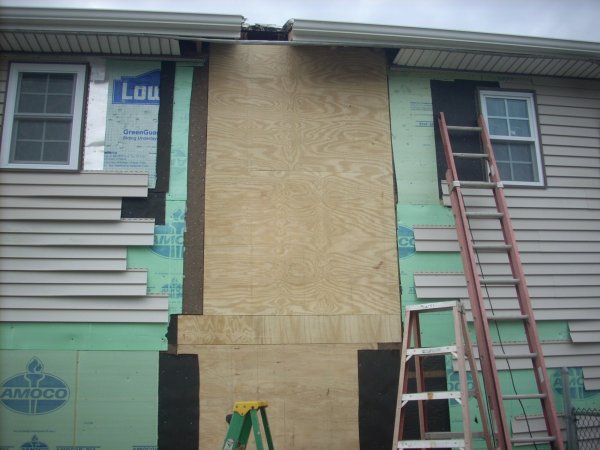

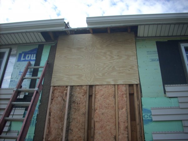

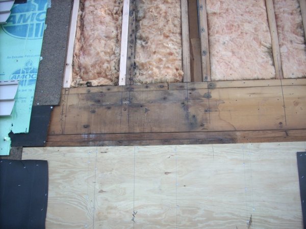

    Ok, well the wall is buttoned up solid! :yes: I didn't get pics of the tar paper because I couldn't stop for impending rain, (which it's doing now)! :headbang: It's 90% covered.
