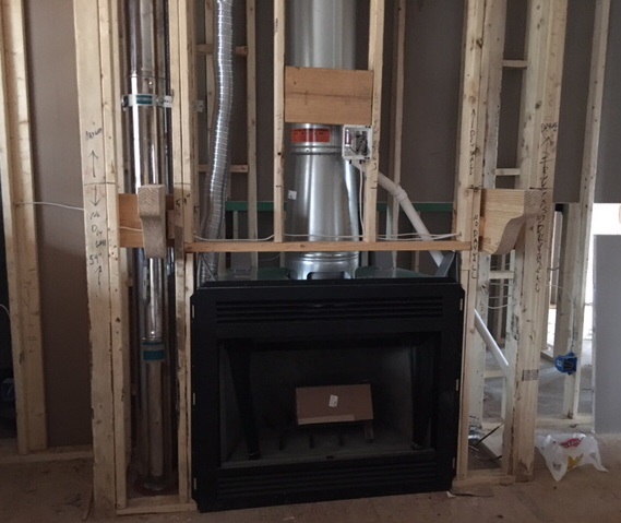

    Hello,

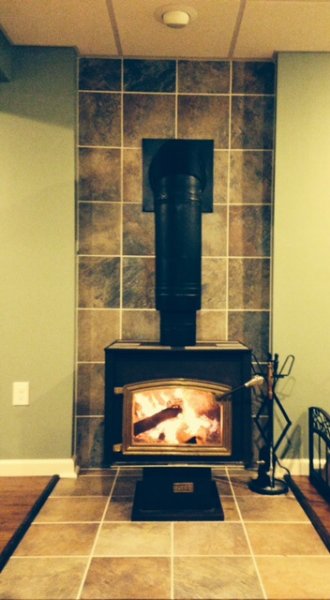

    I have been lurking on FHC for awhile. I have been burning wood for the past ten years and my parents have been heating with wood for 30+ years. A picture of my current setup is below. The Fuego stove is used in our split foyer and does a great job of keeping our house nice and toasty.

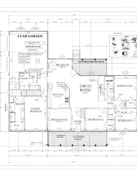

    We are in the process of building a new home (2200 square feet with a full walkout basement) on five wooded acres that we recently purchased. I have included a copy of the floor plan below. We will have a wood burning fireplace (6 inch stainless)for ambiance in the great room with another 6 inch stainless running to the basement for a wood stove or an indoor furnace. The pipe running to the basement is boxed in to the left of the fireplace towards the covered back porch.

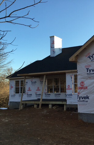

    After an inspection yesterday, I noticed that our builder did not run the chase for the chimneys straight up and out of the roof. It looks like the chase is offset by 4 feet towards the rear of the house. He said that this was done purposely so the chimney wouldn't be so high and that they use 45 degree elbows to offset the chimney. Please see the picture showing the boxed in chase.
    Will using the 45 elbows impede draft or cause issues with cleaning? It looks like offsetting has caused the use of more chimney if you ask me.
    Any advise on this would be appreciated.

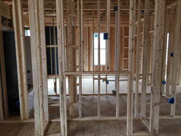

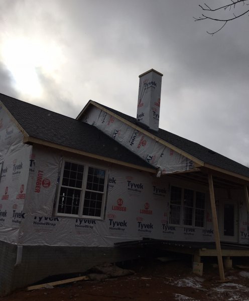

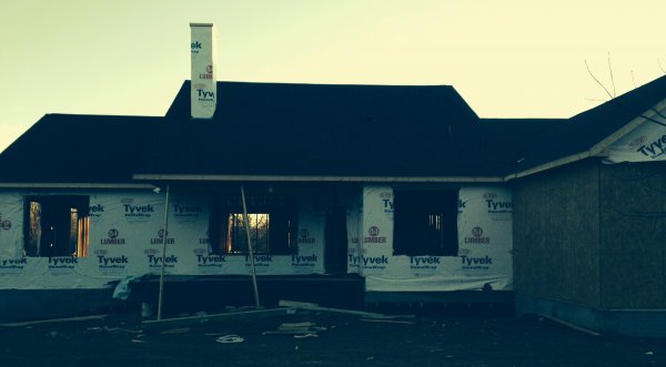

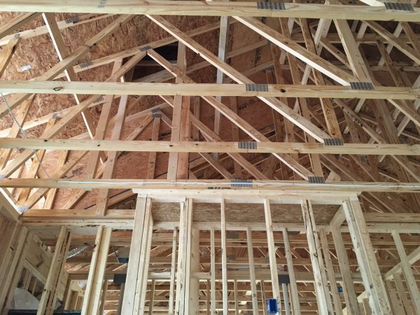

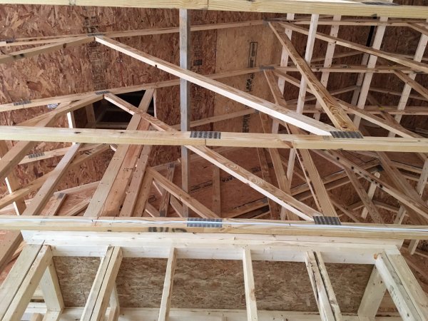

    Thank you all for your input. Below are some pictures from the job site that gives everyone a better visual.
    The framing for the fireplace is straight ahead. The space for the stainless liner for the basement is to the left of the fireplace. I also took several pictures showing the hole/framing for the chase on the outside.
    I didn't see anything that would of stopped them from running everything straight up. I am not trying to be overly particular but this is something that I want right the first time. Please let me know if you see anything that raises a concern.

  7. brenndatomu
    24,423
    158,221
    45s shouldn't be a problem per say...but, you are the one paying the bill...and it is easier to change it now than it will ever be...make them explain why the 45s. His current explanation doesn't necessarily make sense, the chimney has to be 2' taller than anything within 10' horizontally

    We are making progress with the install. The chase was moved so that both pipes can run straight up. As you can see this reduced some of the height that we previously had on the chase and eliminated any offsets. I am feeling much better regarding cleaning and draft issues that we would of had with the previous setup.
    Thanks for your input that got me to this point!
