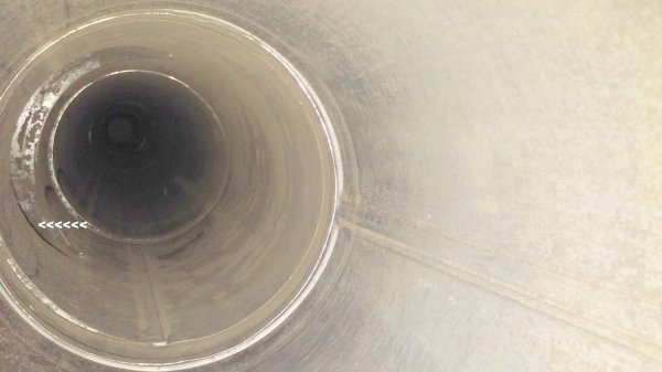

    It looks good Kim, i after_cleaning.jpg s this a crack in the pipe or just nothing.

    That is the tee; this is trying to look up the chimney from the bottom. So anything below the tee is not really that dirty. I might try getting a photo above the tee.

    You are not being very nice and you really don't understand my question. It appears that the chimney AFTER I CLEANED IT might have some harder (creosote maybe?) left on the interior of the chimney. I was asking if the soot-eater thingy would knock this off or not; would it leave the chimney cleaner? I figured those with the soot-eater might could possibly answer this question. If you don't have the soot-eater then you probably cannot answer this question.

    I'm saying almost no non pro cleaning tool will not take off much, if any, heavy stage 3 creosote (the wet, or heavy, or tarry, or shiny stuff) But many non pro tools (including SE) will take off what you have laying on the deck there...

    You got some flaky brown/black, coffee grounds looking stuff out of your chimney; which is normal..............................you weren't able to clean the horizontal section of your set up..........................continue burning and clean the whole thing next time when you get the tools.

    The answer is no. The plastic strings on a soot eater will not attack that hard, glassy creosote at all, whatsoever. They will not even polish it up. :) To remover that stuff takes much more aggressive cleaning methods that often not compatible with modern, stainless steel lined chimneys. The most effective way I have seen is a set of chains rotating on a drill- driven metal disc; sort of like a soot eater gone nuclear. But they would beat the S.S. liner to death.
    As I previously recommended, Anti -Creosoot is a mild acid that will attack and break down those hard deposits without apparently harming anything else. A little chemical treachery and cunning to replace stone- age hacking and chipping. :)
