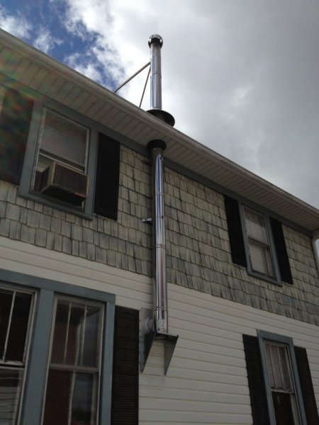

    Bottom up. Roof is too steep, flue is too high above roof line and has a support that would have to be removed to take a section off, and I don't do anything beyond step ladder height if it can be avoided:
