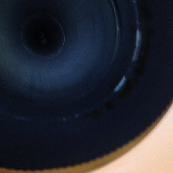

    I'm glad I saw your setup. Mine is nearly the same except for 1-90 deg ell. Since I start on a short horizontal, I use the vac like you, then stuff an old towel
    in the pipe after get my first section in. Then I go section by section with the extensions and the same on the way out. Limited mess with the vac running
    and at the end I run the vac into the cleanup and get the rest. Nice setup!
