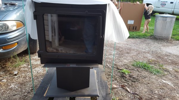

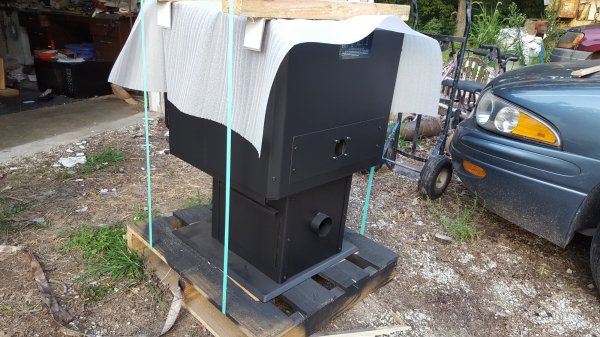

    Well my stove arrived today. Man that thing is heavy to load and unload by your self. I see some aches and pains in my future.

  16. CoreyB
    CoreyB
    Oct 27, 2015
    1,043
    3,421
    South east iowa
    Bad internet right now. It will happen later. Lol

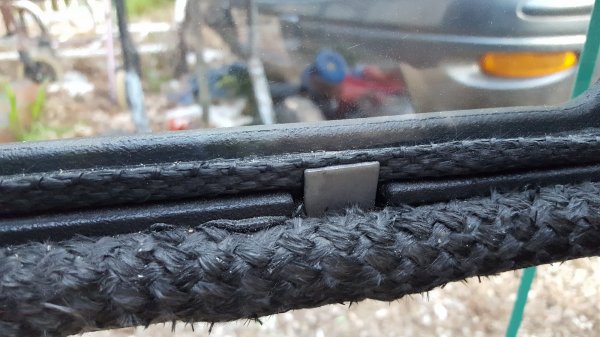

  18. saskwoodburner
    saskwoodburner
    Dec 15, 2015
    2,612
    14,907
    Oh geez, looks like your glass is gonna fall right out!:rofl: :lol: Just kidding of course.

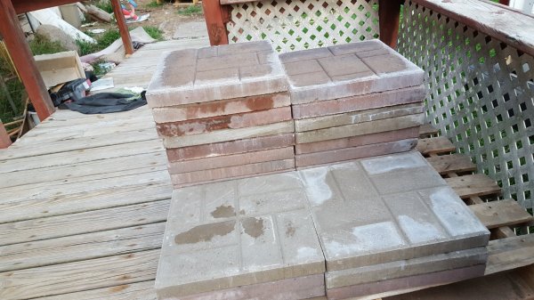

    Man these things are heavy. Fyi others purchased, loaded and unloaded. Got a total of 24 for a buck a piece

  20. HDRock
    17,262
    60,487
    They do look heavy.
    A buck a piece, that's a great deal :thumbs:
