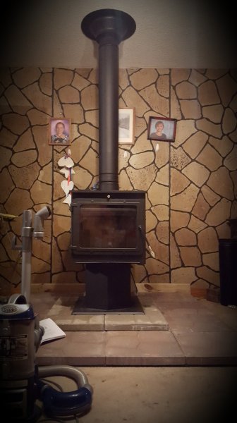

    at that height and straight up without any 90s it should draft really well.
  5. brenndatomu
    25,115
    163,195
    Yes, yes it will...
    Canadian border VT, HDRock and CoreyB like this.
  6. CoreyB
    CoreyB
    Oct 27, 2015
    1,043
    3,421
    South east iowa
    Yes yes it does. It pulls smoke from a match 8 in below the pipe at the ceiling.

    Here is a video of me trying to get a grasp of the air flow.
    papadave, FatBoy85, HDRock and 3 others like this.
  11. yooperdave
    35,717
    224,360
    Regarding the ceramic board baffle at about 1:15 of the video, does the one half of the baffle need to be re positioned by pushing it towards the rear of the stove or is it designed to "hang over" the secondary air tubes like it does?

    Nice stove. Check your baffles at times as sometimes when loading you might bump the baffles out of place. The baffles are fragile so treat them gently.

    baffles generally they are just a bit over the front tube or even with the front edge of it ( from my experience with my NC30) how is the side play in those on the Madison? In the 30 OEM baffles are a bit short side to side, so most of us rig up something to fill that gap, or like me after several years I replaced the baffles with new ones I made with material from one of the heat treat/ kiln suppliers and made them wide enough to cover the full width.

    Seems to me they should be even with each other.
    Edit , pic in the manual shows the baffle boards even

    Yes the are supposed to be all the way back. I was messing with them seing how easy they where to move for cleaning.

    So do the secondary burn tubes lift out? Or do the baffles shimmy out between them?
    yooperdave likes this.
  17. yooperdave
    35,717
    224,360
    On the 13 and the 30, you have to unbolt (unsrcew) the secondary tubes and lower them to remove the baffle. I can only assume that the madison is set up the same.
    Which reminds me....the tubes have to be put back into the same location as the holes are angled for their placement.....
  18. CoreyB
    CoreyB
    Oct 27, 2015
    1,043
    3,421
    South east iowa
    You have to remove the tubes. At least one.

    Well last piece of the flue is on and fire brick 're installed. I think I am about ready to start the break in fire's. Maybe this weekend.
