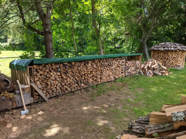

    This might be a little too convoluted to be considered "easiest", but it's a recent experiment of mine. It works for me, but may not for you.
    I hate how water pools up on the tarp or blows around when it's draped over the pile, so I put pallets on top of the stack. Try to make it as even as possible with a slight slope to the back of the pile. Put your tarp over that, pull tight, and staple or tie down to the pallets. The water won't pool on the tarp, it won't billow or catch wind, and it gives the impression of a wood shed roof, even though it's the firewood that's holding it up. When it's time to use the wood it may require some reconfiguring, but if you're far enough ahead it doesn't matter. Take it down when the time comes.
    This thing didn't even budge during Isaias.
