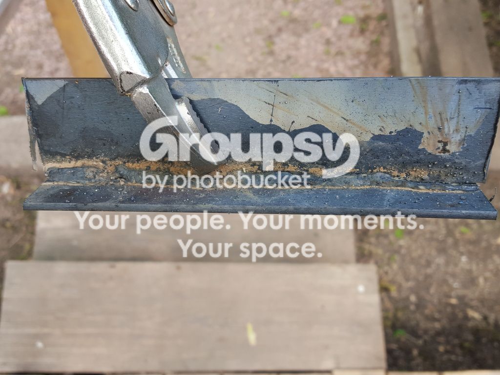

    I finally tried my hand with my welder. Had the welder for a while but waited to pick up an auto darkening helmet, gloves, etc. I went with a Hobart 125EZ.
    My first shot at a fillet weld....think I need a "little" more practice. :)

    Great start!

    Thanks man....coming from you I'm energized to go give it another crack.
    Looking at it I was thinking I went a little too fast?
    I know that 125EZ is a low end system, but the one setting switch and self shielded wire makes it simple for a newbie welder like me. :)

    Your splatter isn't bad so slow down a bit! Keep your tip angle 45* into the joint and your direction angle 5 to 15 *, "no more". Try small little circles as you pull your tip and stay no more than a 1/4 to 3/16 away from your work. Don't laugh when I tell you this but, spray your nozzle with pam cooking oil before you weld! It will keep splatter on your tip down to a minimum. Yes, they make a tip coating spray at + $9.00 a can, pam will basically do the same and is better for you if you breath it! Next, practice, practice, practice… :whistle:
