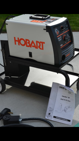

    image.png image.png image.png I found this today for $800 for everything in the picture and more stuff. Anybody think this is a deal I should jump on?

    Ask him or here for a test weld if possible! Thats a Good deal:cool: But make sure it all pans out and make sure theres no "KINKS" to breaks in the feeder cable going to the nozzle. I've seen people try to disguise a kink by electrical tape. If you see that on the feeder to the nozzle, be cautious:confused:

    I would poke at that deal. They are great Welders for the home shop.
    But that 187 is 230V machine. You have 230V power to your house. If you are comfortable with doing whatever is necessary to make it available for welding use (i.e., installing a receptacle) then I'd go for that machine for sure.

    I'm an electrician so getting a 230 receptacle is easy. I'll have to talk it over with the boss/wife and see if we can do it right now. If I do go for it what can I do with a mig welder?

    A LOT. That machine will easily weld 3/8ths steel. MIG prefers cleaner metal to weld than Stick so prep will be important. Technique is still very important if strength of the welds will be critical so read up on all the different positions. MIG can do aluminum with a spool gun but there are limitations.
    The biggest advantage is that MIG is an easy process to learn the basics and then you can work on the more advanced stuff. You will producing decent looking and strong welds in no time. The downside is learning to tune the machine and recognize machine issues vs technique issues. MIG is pretty fast-paced, especially on the thinner materials so I recommend practicing on heavier stuff to get a feel for the machine and understanding what you see/hear.

    Do I need to run gas for a mig or can I do it without?

    That set up comes with a bottle. I have no experience with flux core....

    I saw both the gas bottle and what may be a small roll of flux-core (gas less) wire in the photos.
    You can run it gas-less for sure as long as you have the appropriate wire.

    Yes and yes! With some flux core wire, you do not need gas but "I" suggest you do. It will make a better weld if your going to be outside in any kind of wind, If indoors, no, but you'll choke to death from the smoke! That looks like a real nice set up, just check it out real good. Don't understand why he's selling so cheap and quick.
    And for the record, CO2 is fairly cheap comparison to say Argon or dual gas mix
