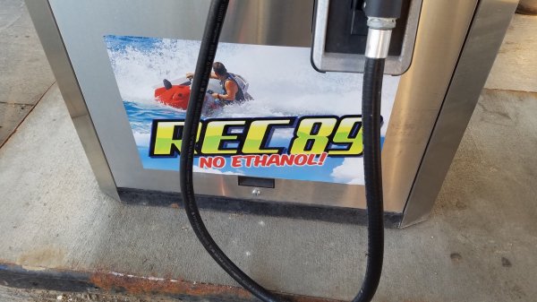

    Are you near a lake or river where there may be a marina? Most marinas have ethanol free fuel. There is also a website listing all the places that sell ethanol free fuel state by state.
    HDRock likes this.

    Not long after this thread I found a place close by that started carrying , e free gas and have been using it in everything for over a year now.
    clemsonfor and Ralphie Boy like this.
