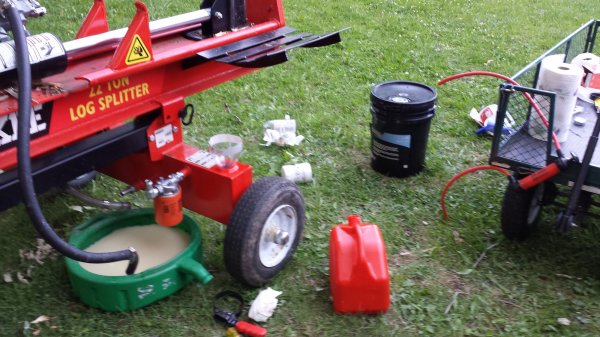

    OK, Got her all fixed up, fluid didn't look very good that's for sure.
    I drained the tank as good as I could, but it was still not all out so, I jacked up the other side and sucked out the rest with my little pump Deal, together with that and the instructions from Elderthewelder I think I got all the old oil out pretty darn good.
    What a freaking mess trying to pour that oil out of that pale, after trying three different funnels the best one that I could find to work was a 2 liter pop bottle cut off :hair:
    Wow it takes a lot of pulling on that cord to extend or retract that cylinder, pain in the azz but I got it fixed up like it should be, oil is nice and clear and it is working great now.
    So now, anyone have any ideas what I am going to do with all this old oil, I think the auto parts stores will only take used motor oil but I'm not sure

    yeah you had some water in there that's for sure. how much Hydraulic fluid did it take? See you went with the Fram filter.

    I agree with what has been said. I would do two changes to get the old oil out. And use the 10 micron filter. Let's see some pics! And where you live go with the lighter weight or ATF which is essentially hydro fluid with add a gives for trans. What ever u like though.
  17. clemsonfor
    clemsonfor
    15,996
    37,474
    Greenwood county SC
    I see the pics. The parts stores take oil yes. Good tip about pull rope retracting ram. And Yea I can see it taking just 5 gallons.
