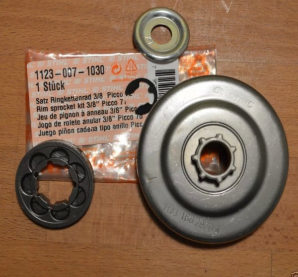

  12. SAWMIKAZE
    SAWMIKAZE
    Mar 16, 2015
    216
    900
    PGH
    Here's what you want.
    And I'll tell you why, it's a mini spline drum. So if you decide you don't like the picco on your 250 you can swap to a .325 rim and continue as you were.
    No brainer to me.
