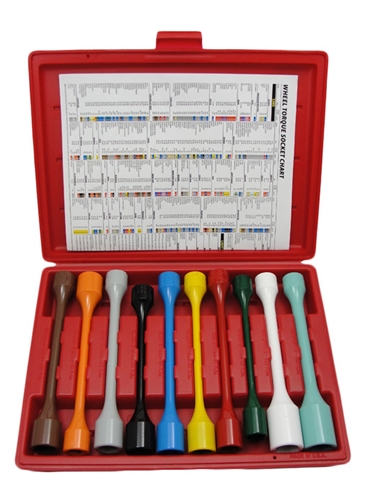

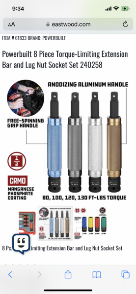

    I managed to get the correct torque limiting socket for my vehicles (orange 21mm, 90ftlbs) and it is indespensible for tire work. I never have to fight them off and I can tighten them with any impact gun. I had checked them with a mechanical torque wrench and the ones testes were showing within 2ftlbs of tightness. Start em by hand and just run them down with a few extra ugga duggas and good to go. Would recommend. I also grease my studs occasionally due to some breakage issues long ago from rust. Nothing better than getting a flat and snapping 3 of five studs trying to get the flat off.
    don2222 and eatonpcat like this.

    The very first thing I do after a shop touches the lugs on one of my vehicles is break them all loose and re-torque with a torque wrench. Revisit with the wrench after one or two drives.
    If you are lubing your lugs, you probably are getting more consistent torque values, assuming you are using a torque wrench. Lubing the threads sparingly is fine. Avoid getting it on the tapered seating surfaces. Technically you should reduce your torque value by about 30% or so for lubed threads unless the specification you are using is specifically for lubed threads. (Really only common for engine internals)
    I do not trust torque sticks. That's just me. But I do not work on cars for a living, and I don't work in a tire shop. It takes me about 60-90 seconds per wheel, assuming 5-6 lugs, to torque my own vehicles with a torque wrench. I know. I'm slow, but I'm good with that. :BrianK:
