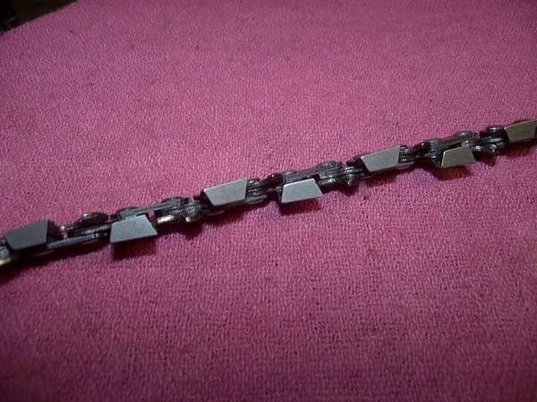

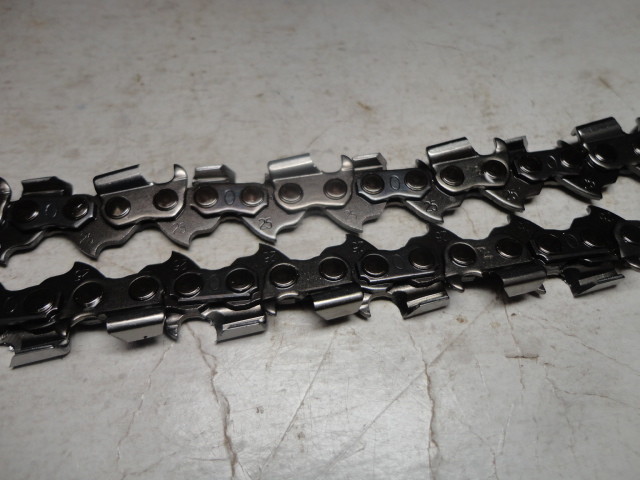

    Thats what you run on your 42" bar...square grind too??? :saw:
    I never knew such a chain existed. Second pic looks like its angled for milling. Is it special order?
  15. The Wood Wolverine
    18,829
    121,184
    I've never used any. A lot of times it's advertised as for carving use. Largest bar I use full compliment on is 28" and while it's a pita to file, it milled like grease lightning!
    brenndatomu likes this.
  16. The Wood Wolverine
    18,829
    121,184
    Just for reference, the pics in my post about full house weren’t right so I asked for a redux.

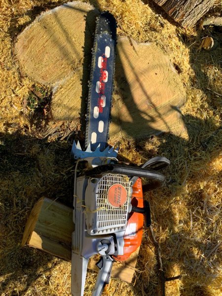

    I sharpened my chain, last night, when I got back to my shop. I took it back out and finished cutting up the Osage Orange, and done some splitting and some of it was pretty knotty, so I noodled several pieces. The saw cut better today, they yesterday. Factory chain sometimes just isn't as sharp as it could be and I think I ended up with a better sharpening job then came new on it. I also lowered the rakers a little and they needed it even after only the first sharpening on the new chain.
    I waited until I was done, just in case I trashed the chain on the stump, but all was well, and the chain is still pretty sharp. The saw cut that stump off just fine, but as you can see, was about as big a stump as I care to tackle with this saw and 20" bar. I know one can cut a lot bigger stump with a 20" bar, but I much prefer to just grab a bigger saw, myself.
