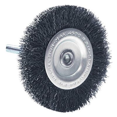

    Sue, because the other guys chimed in good on the gaskets, I'll just comment on cleaning out the channel. If you have a drill (cordless is nice) get one of these and they work wonders:

  4. papadave
    Exactly.
    Only issue I had with mine was the cordless drill is dying (or the charger....not sure which), so I had to use it manually.:headbang:

  5. HDRock
    17,262
    60,487
    Even a little project like that ,running a wire wheel ,is best done with a 110V drill, cordless drill doesn't have the power or speed ,to hang

  6. Backwoods Savage
    48,976
    312,109
    Methinks that depends upon which drill you are using.

    Thanks, Dennis! I will pick one of these up in the the hardware store on the way home.

    +1 Exactly what I use for gasket channel cleaning. Works fantastic and they're very inexpensive.
