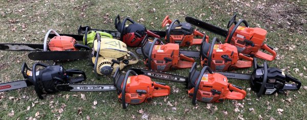

  14. buZZsaw BRAD
    34,686
    214,456
    Great pic! Family GTG outdoors. Whats next on your CAD list?
    Would it be easier to start the first one and by the time you start the last the first runs out of gas?
  15. The Wood Wolverine
    18,818
    121,041
    Lol, yep! But I don’t run em dry. Tell ya what though, if you can start all these saws @ the same time you’ll have my kudos! I couldn’t (There were still 2 more in the basement).
    Saved the Poulan and Pioneer for last and I was out of steam. That big ole bugger is a beast to get running. Feels like an old locomotive or something. Choke on, off, on, trigger some fuel for a pull, choke off... you get the idea, lol. Had to come back to those two at the end of the day. Guess I’m getting old? :BrianK:
    Next? I have too many already! I’d like to thin the herd and the 592 sounds very interesting. But doubtful. I’d like an old skool 288 or a 371(or 372xpg).
    Rosco, buZZsaw BRAD, Ohio and 3 others like this.
