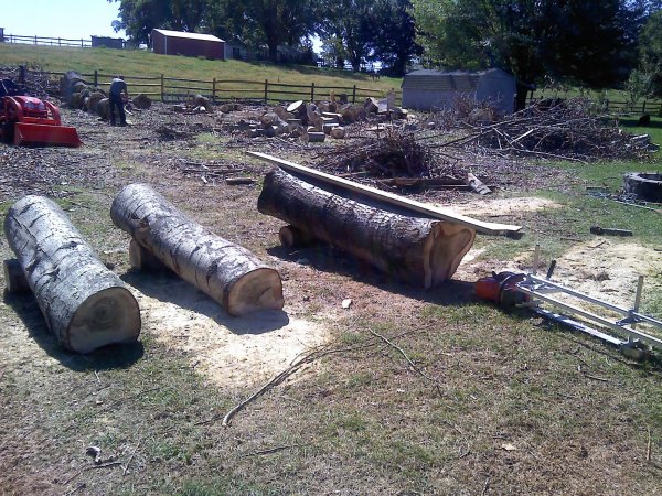

    Not a real steep learning curve on the MKIII. For small enough stuff, use a 2X screwed to the top as a guide for the first cut. Big stuff, an old alum ladder works great. Then it's just keeping the saw at it's sweet spot in the revs and keeping the chain sharp.
    If you can prop the logs, there will be a lot less effort to get the mill through the cut. You'll be thanking yourself the next day. And a huge part of the learning curve is in stickering and stacking. All your work can go to chit if not properly placed on a flat level foundation @ the right location.

    I appreciate those tips. Just use a 2 1/4-2 1/2" screw to attach the 2x4 to the top of the log? A stock 562 should be able to mill pretty proficiently right? Once you have it milled just make sure to place it on level ground like on the shop floor to dry?

    I use at least a 2x6 or better a 2x10. You'd probably wobble a little with a 2x4. And be very very cautious not to saw into the screw you use to attach the guide! I've done it more than once! Curse words were said.

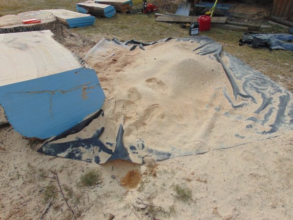

    It's a good idea to lay down a tarp if you don't want to kill grass. The chip is fine and not easily cleaned up.
    Use scrap latex if you can't afford AnchorSeal. In the above pic you can see I painted the log before I milled it.
