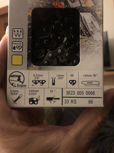

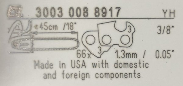

    So while reading the manual today I see the drive sprocket gauge is 0.062”.
    I got an 18” green bar
    And it shows it’s a 0.050”
    chain is also a 0.050” gauge…
    something I’m guessing I need to correct before I go start making chips?
    an additional question…
    what’s the icon with the pulleys above the oilmatic mean?
  2. The Wood Wolverine
    18,829
    121,184
    You are good with the drive sprocket gauge.
    That icon is showing the chain is pre-stretched.

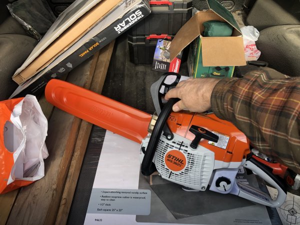

    I’ve got the rim drive.
    thanks. Makes it much easier to understand.
