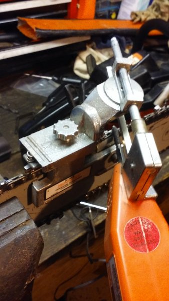

    I hand file after every tankful of fuel just a stroke or two. Then use the Granberg when I want to make sure it is right.
    I would purchase a new chain or two look at the teeth then try to get the old chain look like the new one practice you will get it.
    I also have and use a cheap grinder it does a pretty good job if your in a hurry, also have a Electric Granberg
    but still prefer the manual one would like to try the Stihl or Perfrd 2in1
