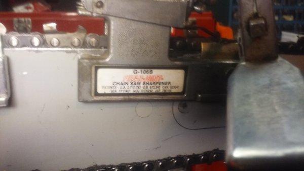

    Get yourself a Granberg G-106B. I've had mine for years still works well.

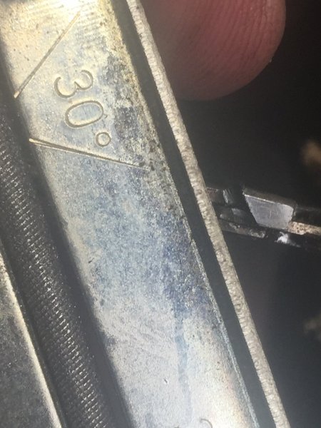

    582D985B-3A5E-4B56-B9F2-5155EF6E1E6C.jpeg 6CAA21EC-9E17-4D78-AD5B-FBE9844184AA.jpeg Note to self .
    IDIOT YOU KILLED THE ANGLES . Angle file ,tight chain,vice and glasses . Only brought three teeth back in line so far

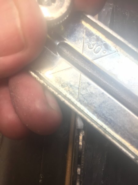

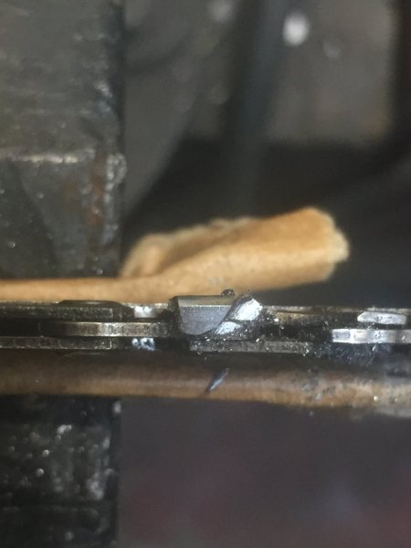

    63763688-33CB-44D0-BB5D-636516EDB0D6.jpeg 0061E4EB-642C-4934-BC1C-88F0637B0498.jpeg I’ll officially embarrass myself.
    48 strokes to pull this one tooth to 30 degrees.
    Chains probably goosed and I’ll have to do the other side to bring it back to been equal
    Hopefully I’ll stop some other newbie making the same mitsske
    Ok you can laugh or cry now

    That’s a lot of filing graham. At least you got it figured out. I’d clean the filings off the chain before using it with that many.

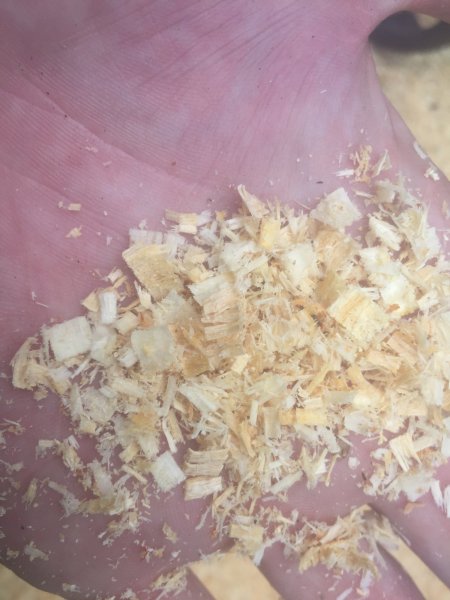

    ECBECE94-11A4-450C-9A58-9AE222373270.jpeg Long time since I had actuall wood chips . How did I not notice sooner
    Marvin, brenndatomu, milleo and 9 others like this.

    Your file is shot if you had to file 1 tooth 48 times o_O
