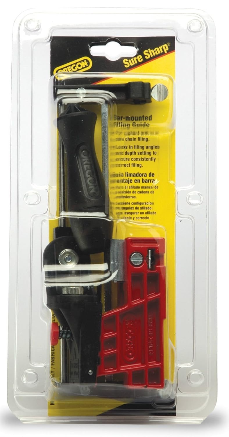

    I think I will stick with the round filing for now. jon1212 gave me one of these and some files so that is what I will continue to use.

    Perfect. Hard to beat a file-n-joint.

    That is a fantastic tool and great to learn with. Use a red sharpiee to coat the cutter of the tooth then use the give it 2 strokes and make sure it is taking off what is needed. Once you learn the tool well you should get each tooth almost exact. And to measure the tooth length a set of needle nose vice grips works perfect. You can pick it in to the length you want and it will just slide on to the tooth with the point sliding into a groove as soon as the tooth is short enough. If you go to far it is sloppy and has excess space. Just leave it and go to the next. One or two shorter teeth won't hurt.

    Spot on:yes:

    Great advice! Never thought of the vice grips, myself....that's a slick trick Corey:thumbs:

    I used micrometers for a long time and stumbled on to the vise grips some how and quickly found that it was faster and easier and more accurate do to you never habe to 're measure and it stints on the tooth better.

    That is an excellent way.

    I think I understand this...so you are using one half of the jaws to slide into the tooth...kind of a depth guage?

    I will try and get a vid up or photo. I have a few chains to sharpen this afternoon.
