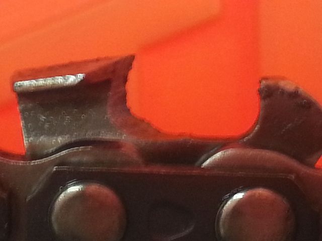

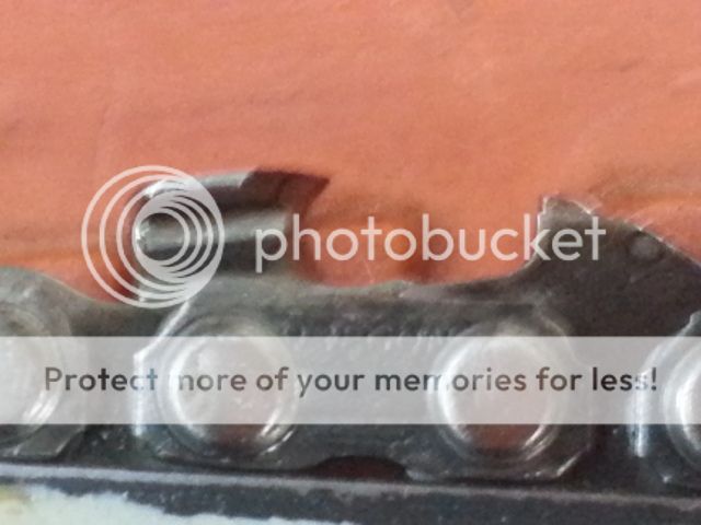

    I've only done 2 or 3 chains on my Roughneck grinder and I have not been happy with the results. The chain will not self feed. I think I am not getting enough hook on the chain? I've tried 30, 60, 0. I've checked the angles on my grinder with an angle finder to make sure they are right. Any ideas what I may be doing wrong?
    Here is a pic of a ground chain
    Here is one that I filed

    Looks like the wheel is not coming in at a steep enough angle on the grinder?

    That is 60* verified with an angle finder. I found where Stihl said to use a 40* side plate angle and then I have seen where they say to use 60*. I keep reading were everyone is using 30-60-0 so I am confused:faint:

    I use 60 on my grinder.
    I am still fine tuneing mine in. It will self feed but not like I want.
    How are your rakers? They look good but what they measure?

    Believe it or not, the tilt on the table can make or break a self feeding chain.
    Try using the tilt @ 10 Degrees with the same other two settings without touching the rakers yet.

    I'll try that but when I file a chain I don't use any tilt. What would be the difference on a grinder?

    With a hand file, you can controll the hook.
    With the grinder, the tilt works with the arm angle and base angle to give the proper hook
