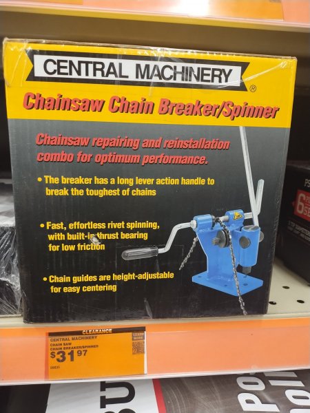

  16. Ward Hoarder
    Ward Hoarder
    Dec 20, 2017
    740
    5,680
    West Virginia
    Didn't know were to put this. Seems like a good deal. It's still not cost effective for me to make my own chains.
  17. Eric Wanderweg
    8,716
    69,265
    I have that same model. Both the breaker block and punch failed early on for me, so I ended up making replacement parts and heat treating them myself. It’s good now but if I wasn’t a machinist I’d have been in a real jam.
