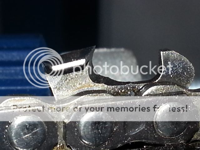

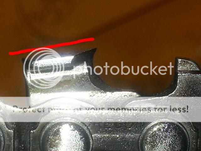

    Ok, here is two problems I have right now. How do you solve them/what do you do about them?
    Problem 1: Chain looks like it hit something at some point, most cutters are ok and sharp, but a few of the cutters are like pictured, almost straight across. Do you grind the hell out of it to get it back to the correct angle? Just sharpen those few cutters normally and leave the top straight across until you sharpen enough times to fix it (essentially grinding it back 1/8" or so...) OR???
    Problem 2: I have a chain that I love, cuts great! Don't ask me why, but for some reason this chain has always treated me good, and I can't say I have treated it good! ;) But it's starting to get real long hooks. See the picture... I've sharpened it so many times with my dremel, that it is getting rounded below the top of the cutter, and the top of the cutter is protruding forward. It is super sharp, and cuts great. But do I leave it? Do I file off the hook and then re-sharpen... What do you do with this? I'm sure a grinder would solve this problem since it comes straight down into the cutter and would grind this point off.
    Maybe I should just bite the bullet and buy a grinder? Cheap but GOOD grinder links please!! :D
    Moparmyway likes this.
  15. clemsonfor
    clemsonfor
    15,996
    37,478
    Greenwood county SC
    Wow that first one is rocked hard. If its just a few I would just hit with a file and leave it.
    The other chain looks like your file is too small or your sharpening and way too steep an angle!!! Something is majorly wrong there and should not look like that
  16. 94BULLITT
    94BULLITT
    Sep 20, 2014
    2,446
    7,189
    Frederick County, VA
    Problem 1: just file the few rocked out ones back til they are in good shape. No need to file them all to that length.
    Problem 2: Your file is too low.
  17. Machria
    Machria
    2,432
    5,009
    Long Island, NY
    That's what I thought on #1. I knew I didn't have to file them ALL back that far, but the question is/was do I need to file the "rocked" ones all the way back... I guess the answer is yes. ;)
    #2, Yes I assume that, but how do you correct that? The file, dremel... anything I use on that particular chain seems to go deeper and deeper .... ? I've never had that problem on another chain...
  18. clemsonfor
    clemsonfor
    15,996
    37,478
    Greenwood county SC
    I have never had a chain that looked like that when I used a round file by hand. Now I grind with a grinder so it obviously does not look like that.
    If your dremel thing makes it look like that get a hand file to correct it or get someone with a grinder to whack it back true for you
  19. Machria
    Machria
    2,432
    5,009
    Long Island, NY
    Just that chain! None of my other chains look anything like that! Have no idea why? Maybe because that is a LP chain?
  20. clemsonfor
    clemsonfor
    15,996
    37,478
    Greenwood county SC
    Your not using the same file on 3/8LP as 3/8 full size are you
