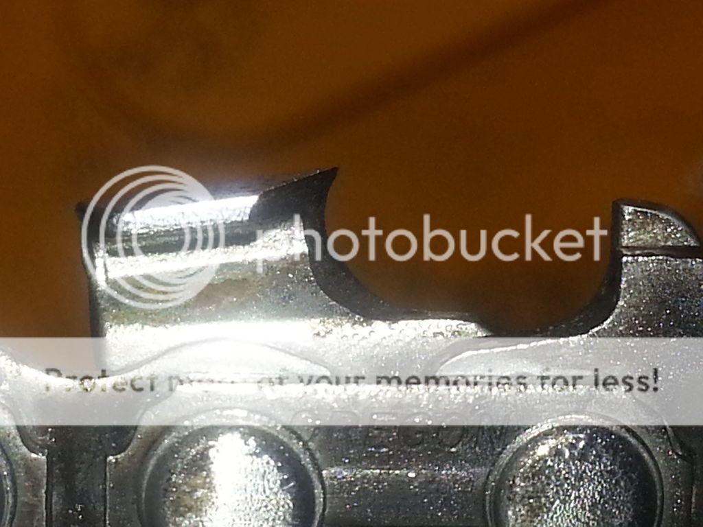

  16. Hedgerow
    Hedgerow
    1,495
    4,849
    SW Missouri
    Most likely did not get all the damage removed.. On real buggered chains, sometimes it takes a few more touch ups to get it really proper.
    Those round ground, full chisel cutter points are easy to litterally "bend downward" when they hit something hainus. like rock or t-post or...
    And they can be damaged a long way back.

    Clem, a magnifying glass or magnifier app may be helpful to look at the cutter.

    Ok I hit two teeth. Did not change anything from before. This is 55/30/10. I only did two cutters on the I guess left side it is? Pic of the table tilt to be 100% I am tilting right way. uploadfromtaptalk1446174169841.jpg
    And then some pics of the tooth. Havent measures or filed the raker in I am not sure how long so forget raker height I'm this critique.
    To me it looks as good and a bit better than before I changed and I could live with it then. I think that jacked up chain I just didnt get all the damage out and a combination of the edge metal that was left from me grinding the heck out of the chain as I was blueing the cutters :). Before I was grinding like about 58/30/0 uploadfromtaptalk1446174465988.jpg
