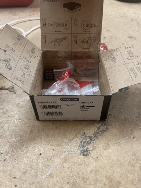

    I think you are right. When I backed started unscrewing the clutch inner part it would spin freely. Also it looks like the oil pump splines will not take the narrow splines on my new clutch cover. I also see on the box lid there are several options for spacers. I would really like to make this work but may go back to the old clutch cover since I have a ton of wood to cut this Saturday.

    Were there any other parts in the box ?
    Can you actually see if the splines on the new clutch drum fit down into the oiler gear ?

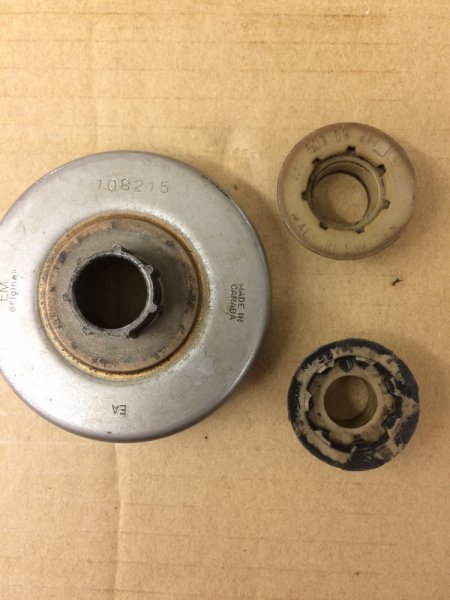

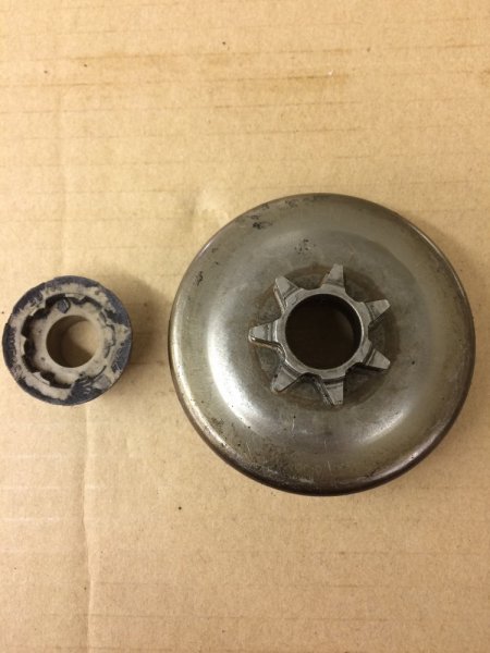

    This sometimes gets real tricky when converting. You have to research and find the right worm gear (as its called) that matches that drum's splines. Usually you can find this with some searching where someone before you has done the swap and someone shares what model saws worm gear they used, or exactly what kit worked. The internal diameter and bevel is very important on that piece, as is the spline match to the drum you use.
    This vid shows how I remove the clutch. Then it shows you a different style "spline" set-up.
    These pics also show the wide and narrow splines. Can't intermix. Lots of research in your future, lol.

    :yes: This exact scenario is why I personally wouldn't advice someone without deeper knowledge to swap out a spur drive for a rim type. Been there, done that.
    Paul Dokken If I had to advise on a new worm gear, I'd tell you to get an oem replacement. Then, if you still want to do the rim drive conversion, get a kit that has the drum and a worm drive that is specifically for your year 450. And make sure it's .325. If you run your chain tension a little tighter, and practice different cutting techniques, you will reduce the number of times it throws the chain.
    If you go here: 325" Rim Sprocket Kit for Husqvarna 450 455 460 Chainsaw - Unbranded It says it's for your 450. But look at the splines where that oil pump worm gear touches. Through the years, one generation 450 may have that type worm drive. Lots of variables.

    Those pics are from a thread for a Husky 350 and 346. Not interchangeable. Another pic just to show variables.
