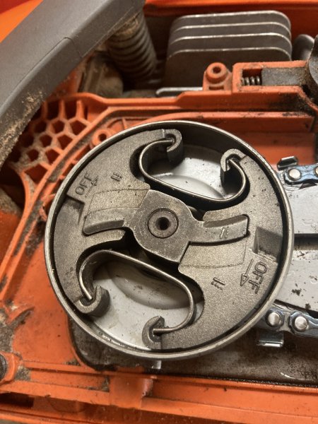

  5. The Wood Wolverine
    18,907
    121,930
    Not all cranks have the hole for oil. That home-owner saw probably does not. These swaps aren't always as easy as getting a different drum. On the end of that rim carrier there are splines. Make sure they fit into the plastic worm drive on the saw. Sometimes you have to swap that plastic to fit the splines on the drum. That plastic btw, drives the bar oil pump, so this isn't something you want to overlook.
    Can you post a pic of the clutch and drum as it sits now?

    Here are some pictures of it. I held the old one up to it and it looks to be the same size.

    Easern Central Alaska
    I never thought about using the screw driver and hammer to wack the clutch for removal.
    Guess it would work in a pinch.

  15. The Wood Wolverine
    18,907
    121,930
    I’ve always removed em that way. The little slot where it says off and the arrow is for screwdriver placement. I wouldn’t be banging on that ear. I use a string in the cylinder instead of a piston stop. Just have to make sure it doesn’t get into a port.
    Paul Dokken
    As questioned above, can you spin the drum with the chain and bar off? These splines fitting in your oil pump drive gear?
  16. Mag Craft
    Mag Craft
    Dec 15, 2014
    4,802
    27,739
    South East Wyoming
    It could be that you got the springs hot and are now weak. So even at an idle they will allow the clutch to come in and spin the chain.
