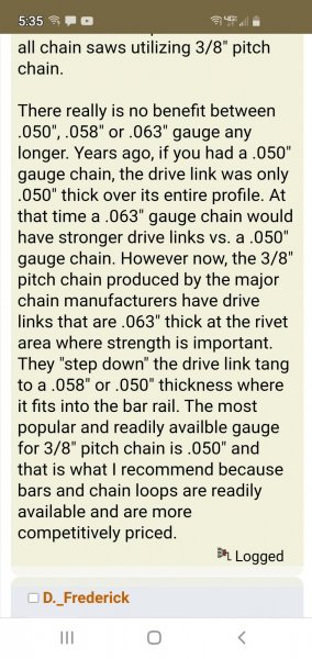

    So I Googled it and this came up. Maybe this makes more sense.

    The outside width of the chain is only 13 thousandths wider in 63 gauge compared to 50 gauge.
    Not enough to talk about.
    But having snapped over a hundred chains in my career . I can guarantee that 63 ga is stronger than 50 ga.
    Yes big bow bellied bared racing saws have more actual horsepower and torque than most all fallin saws.
    But, put a good set of dogs on a race saw and get up on a spring board, 3 boards high. Take your race saw and dog in for starting your Humboldt face on a big hard old growth western hemlock and see how long it takes to rip your chain in half.
    It happens.
    I don't know a timber faller running 660 s ect that used 50 ga chain. .063 ga only.
    I have run 50 gauge on 266 s, 044s, 371+372s ect with 32" bars . And even those little saws would break a chain on occasion.
    5 cube saws and bigger would wreck them pretty quick. Especially on 36" bars.
