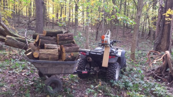

    Cmon luke I want some pics of that hedge..
  9. lukem
    12,322
    66,990
    Theres a cart load pictured above. Usually it is neon yellow when fresh cut and turns dark orange later. This stuff is already orange.
