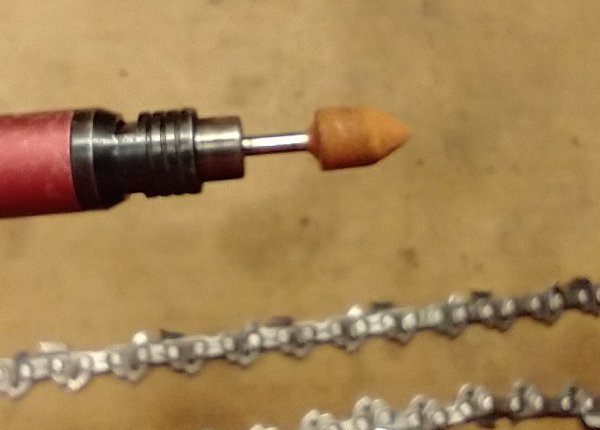

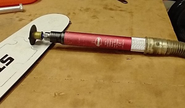

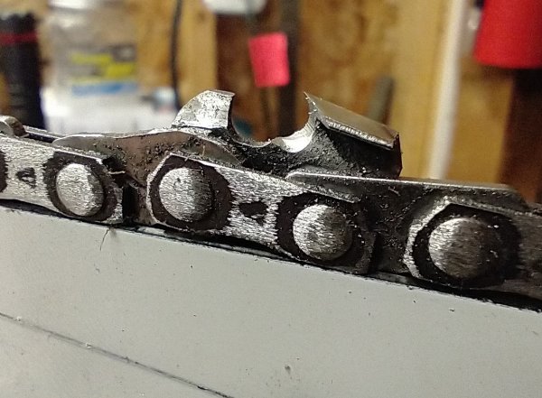

    I did up slightly used Stihl PM3 full chisel chain today for this experiment. Removed the safety bumpers then did the mods listed in the first post. I haven't ran it yet. Probably won't until at Kevins GTG. I'll have a new Picco Super yellow chain with me in case this is a failure on my part. That lil air pencil grinder was the weapon of choice this time around. Disc for the rakers and heels and the stone for the rivets.

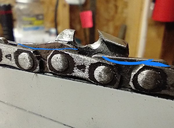

    I saw a chain last week that was modified safety chain where they cut the bumper off but left a piece next to the raker and squared off the front of both. He said it helped push chips out of the cut and kept them from getting under the next cutter. I saw the chain cut and it was really moving the chips. I picked up a chain like it and will combine all the mods and see how it turns out.

    What is the reason for clipping the heels? Help chips exit easier? Less weight? Both? That area shouldn't be touching wood as its lower than the working edge. I'm totally new to doing anything outside the norm on a chain so thats why I'm asking.

    it lets the chips get out easier.

    Thats what I was thinking because it opens up the area they "squirt" out of. I probably should test mine before the GTG.

    You could lower the drive links too, especially the one under/behind the cutter. DBCFFB6E-9343-432C-BBD6-41F36A802AC6.jpeg

    That should be easy enough. Thanks for the tip.
