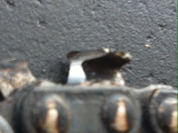

    I have had rocked chains where i had to remove 1/8 of an inch from the top plate to fix them ,a grinder is the way to go for this ,you will burn up a couple files fixing the chain by hand maybe ,but it can be fixed with a file also if thats all you have .,seems like a waste to remove 1/3 of the cutter sometimes ,but if the corner is rocked ,that is the only way to fix it

    No way would I hand file a badly rocked chain. Like he said you will ruin some files and take forever to do so. Way easier to grind it out. But on a cheap chain I would just buy a new one. Most places charge at least $5 to grind some charge $7-10 to grind a chain that may cost $12. Some shops can't grind well or dont touch the rakers so its still not great. No wonder many homeowners just buy new chains.

    The point on a full chisel cutter is of utmost importance. If it's damaged or missing, the tooth may still try to grab and rip, but it will not sever the fibers properly. Top plate angle can be anywhere from 15 degrees to 35 degrees and still be effective. More hook under the cutting edge = better self feeding but shorter edge life, and less hook = more pressure required but more durable.
    Lotsa hook on this one and high rakers to keep feeding at a manageable level. Low rakers are not your friend in most instances. Proper sharp and un damaged cutters will give you good, smooth service..

    I already "knew" this but now I know this. Nice picture. Certainly puts " a little" damage into perspective. Thanks.

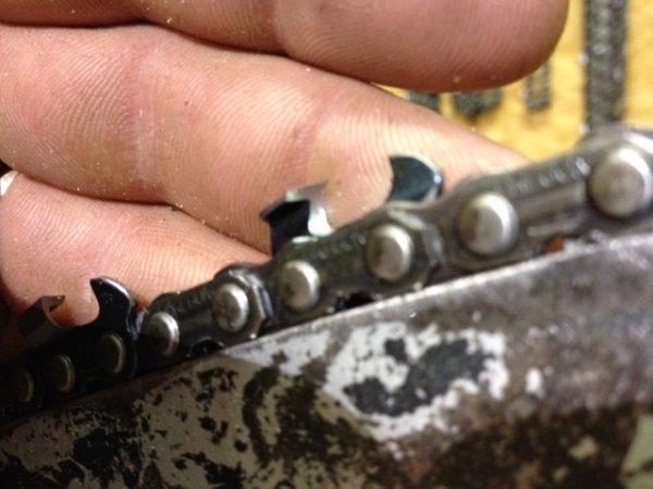

    More pics of the same link. Its in front of the double left hand cutters, where the chain is spliced. Easy to find again.
    Definitely missing that bee stinger point in Hedgerow pic.

    Yep just rocked. Take it back till you get a sharp point.

    I've been trying to avoid this because I'm a tight a$$, thinking-the damage isn't that bad, I will wait till it files out over time. Poor performance has changed my mind. Thanks for the replies.

    If its one cutter leave it but if many are like that fix it
