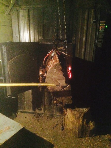

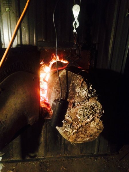

    What kind of wood are you burning?
    Oak and locust will bridge up and go out.
    This is the kind of stuff we burn. Big ugly wood dump stuff ,, well dried ,,, some times beyond ideal but it's plentiful.
