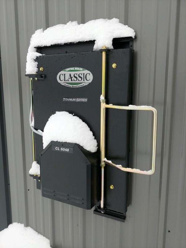

    I've owned central (OWB) since 93. I remember they had a 15 year warranty on them. The last one I bought, has a 25 year warranty on it. There may be something about a lifetime warranty, but even when I bought it, I wouldn't believe it.

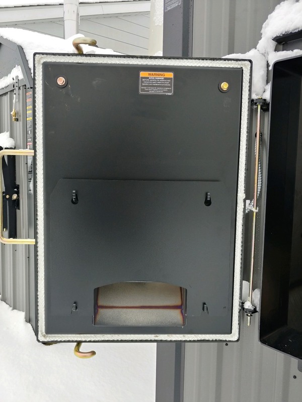

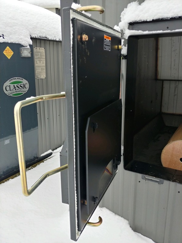

    The pics of the doors you posted show the baffle plate on the inside of the door. That is what I have on mine and yes, it does have a warp in it. I think this is year number 11 for it. The only trouble (?) I had was to replace the circ pump cartridge about a month after installing it.
    Like ironpony has pointed out, that stove has been trough a lot of ups and downs temperature wise. All of this sitting out in the elements. Heck, the wood stoves on the inside of houses have doors that also crack!
    The OWB we have has served us well.
    Good luck with the claim; $300 over the course of 18 heating season is nothing! You're talking about less than $17 a year! Heck, more $$ worth of wood goes through that in one winter.
    Keep us posted, please!

    Those plates do warp. My 2006 CB 6048 has 2 of them the one closer to the fire box has warped significantly the one behind it is still fine.

    Yep, the situation sucks, Kevin- I totally agree with you on all points.
    But like you’ve mentioned and others have offered similar advice... drill the hole, and either goop up the whole crack and add refractory or a heat shield.
    I’d keep the $300 bucks back for something else and snub my nose at them.

    For those of you with the new style door with baffle: What is the thickness of it?
    yooperdave, Screwloose and Eric VW like this.
  7. yooperdave
    35,929
    226,115
    I'll measure and let you know.

    24,568
    141,750
    I’ll wager 11 gauge.

    35,929
    226,115
    Well...……..
    You win! Sorta. There are two plates of 1/8 back to back. That is, measured with a tape measure.....and the use of a pen light led flash light.....and no glasses on!
    My guess is that with the two plates, the warping is less pronounced or more controlled sort of thing???

    Kevin in Ohio

    35,929
    226,115
    I have never removed them. Tomorrow (daylight) I'll see if they are secured to each other or just butted up against one another. But, there is no gap between the two.
    Looks like they are attached to the door with "spacer pins" of some sort.
