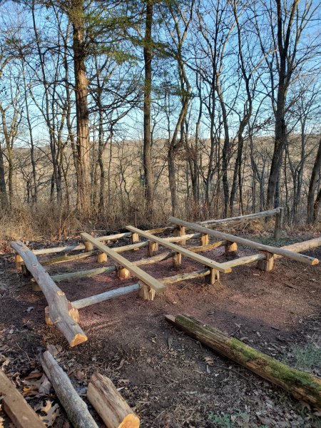

    I'm concerned if those skinny crossers are going to be able to handle the load. Wood weighs a heck of a lot and it's concentrated in such a small area.
    I'm not trying to dissuade you, just going by what my eyes are telling me.

    I had thought about bracing them in between - add some crosswise. Do you think that will help? Or should I add additional beams same way? Any advice is welcome.

    As someone who’s made the mistake of trying to build an elevated woodshed floor, I’ll just suggest not doing it.
    Your shed is going to hold 3+ cords, and with most hardwoods that’s 10,000 lbs+ when they’re green. Building anything that will hold that weight is a serious engineering project.
    I’d suggest doing some basic retaining wall and fill work to level up the ground, then putting down pallets to elevate the wood.
    Once you have the base set, sink posts around the perimeter and build a roof on them.
    Basically, use the ground to hold the wood, and only use your structure to hold the roof

    I would go with more and maybe bigger diameter than what you have lying there now.
    How thick are the boards going to be on the top?

    Putting additional supports (the pads on the ground) in the middle of each of your spans will help carry the load immensely. Think about it this way...would you drive your car/truck out on that? Well, that shed loaded with green wood will weigh somewhere's 2-3 times that!
    But I guess I wouldn't argue against just digging a lil out of the slope and then use the spoils to bring things up down slope (have to only dig out half as deep that way) then all those poles can be the uprights to support the roof...and IMO you do want a roof...dealing with tarps gets old, fast!
    A skilled operator with a skid steer or mini track hoe would be able to level up some tiered spots for sheds in a hurry.

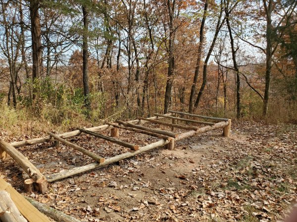

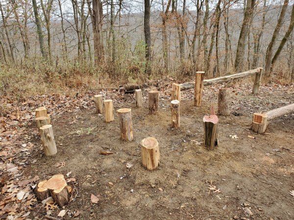

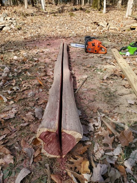

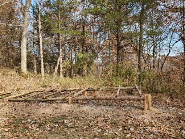

    Tore it apart yesterday and laid out where the additional supports will go. That will give me a total of 16 supports for my 8x6 section. That's 12 more holes to dig :headbang:
    On the plus side...I halved a 6 inch log pretty easily with my ripping chain. Thinking about these as beefier beams.

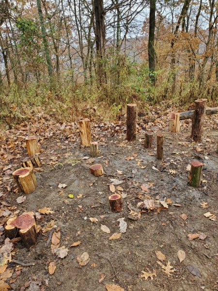

    I didn't give up... bad weather and laziness plus a little additional "noodling".

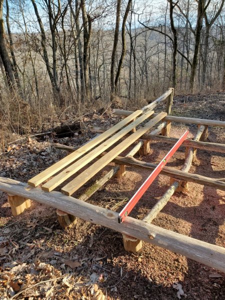

    Got all the holes dug and put the logs in.
    Then finally found a way to mark level so I could cut them.
    Today I finished leveling and put some bracing in between. I need to cut one more log in half and screw everything down and I'll have my baseboards.
    Next up...cut down a good size tree and attempt to use my Alaskan mill. Most of my trees are about 6 inches wide so I'll hopefully have some 2x6s for my floorboards.

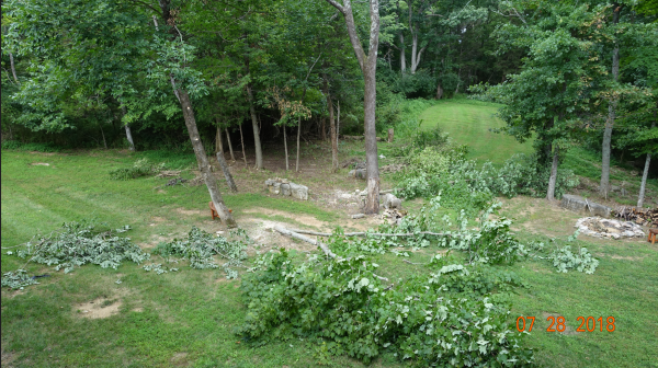

    Heh. I just found a picture of the very first tree I cut down. The woods looked like a jungle. Compare this picture to the one earlier in my post and you can see that I've done a ton of clearing in the past few years.

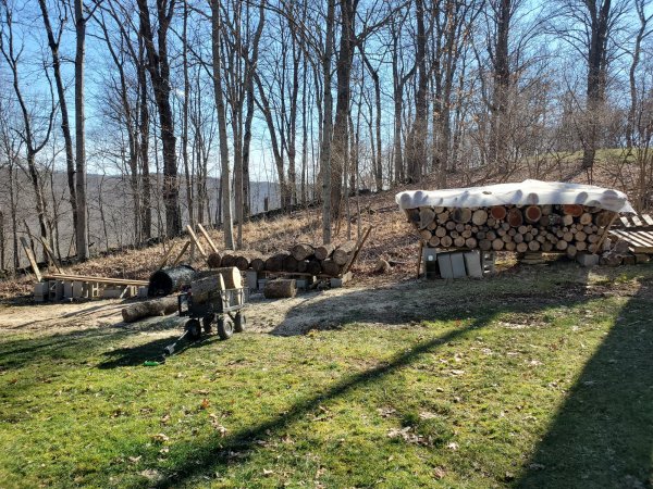

    Easy Livin' 3000 Thanks for the advice.

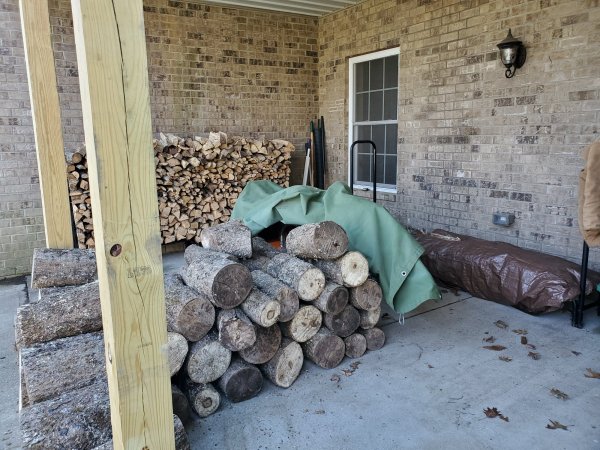

    I modeled this after my stacks with the rounds that I posted the picture of earlier. There are 4 cinder blocks spanning the 8' 2x4s. Since they are holding up nicely I didn't think I needed more support below. So, the plan was that the 1/2 logs would act similarly to my cinder blocks.
    Then, I'd put the 2x4s like this:
    I do have the blocks that I took from my original pallet structure and could certainly use them. They did sink into the ground and topple my pile which is why I started this project in the first place. :) Plus, leveling them was a pain in the bum.
    I put the "little" logs you can see there as additional structure to keep the buried logs from wobbling.

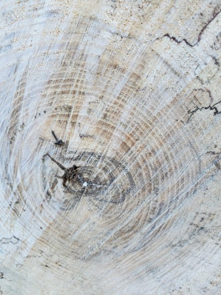

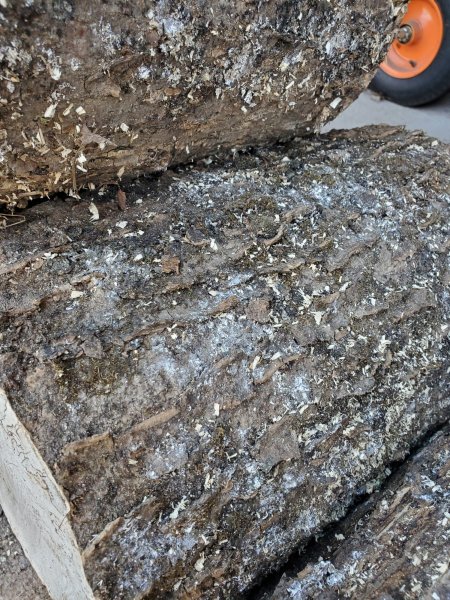

    I haven't given up. Switched attention to getting next year's wood split.

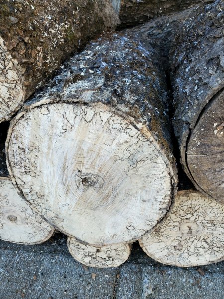

    Can someone help me identify this?
