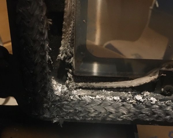

    Good question! The door glass gasket is damaged, and in need of replacement. The stove is only 3 years old, and I'm on my second gasket, soon to be third. It's failing in the lower left corner where the seam is, for the 2nd time. The gasket is still holding between the glass and the door. I think the next time I replace it I am going to place the seam in the upper right corner. Is this a problem I need to be concerned about? IMG_9358(1).jpg

    Is there something catching on the gasket? Is there adhesive holding the gasket in place? It looks like there may be an air leak in that corner.

    Nothing is catching on the gasket, no adhesive, just lay it in place around the edge of the glass and secure with 7 metal tabs. There's definitely something going on in that corner, maybe it is an air leak. Offhand it appears the gasket is fine between the door and the glass, it's the inside part that is failing. I'll take a closer look when I replace the gasket, which may be tomorrow.

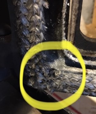

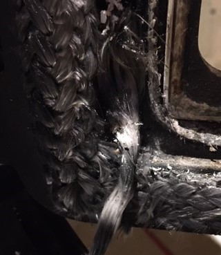

    An update on this failed glass gasket from a month ago,
    There is an air leak in the door gasket right below the failure. When I replaced the door gasket last year, I used some extra cement at the joint, thinking it would help seal the ends together. That was my failure. It created the leak, which I'm sure had to cause the window gasket problem.
    Using an old glass gasket, I cut a 14 inch length, to replace the failed section. I then used a strand from an old door gasket, and placed it when the air leak is. So far it seems to be working. The yellow circle shows where the air leak is. The other picture shows the temporary piece of gasket blocking the air lock. I'm hoping this gets me through till end of this season.

    Has anybody tried cutting the gasket ends on a diagonal so the ends overlap?

    That's a good question. I'm thinking next time, I may overlap it by a 1/4 inch or so, and maybe weave the ends together before setting it in cement. I'm thinking the rounded groove the gasket sits in, should help keep the weaved ends together.
    Another question, it seems like all the instructions for installing a door gasket, say to butt the ends together in the lower left corner. It seems like that is the hottest area in my stove, that's where the ash collects from the air flow in my stove. I'm wondering why not make the ends meet in the upper part of the door?
