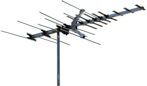

    I have vhf and uhf antennas for a number of years they are on a 40 foot tower plus on top of a hill so it is up there. Augie is correct the height keeps the signal clear and a standard fm inline booster reaches more distant channels. The wire mesh bow tie antenna is a Terrestrial Long range digital(uhf) that replaced the arrow shaped one, an older Winegard (vhf) that is not needed now, Cleveland, Pittsburg and Stuevenville no problem, about a 100 mile max, hard rain or snow breaks up the distant channels some. Looks like Amazon has about the best deals on antennas but the height was the best improvement. We thought we were missing out on real TV so I had Dish installed 18 months ago and it will probably go in 6 more when the contract is up, $100 a month is getting old, we enjoyed renting movies for a lot less.

    What are you using the VHF one for? TV doesn't use that band anymore.

    lol, good point Grizz, as you can tell I'm not to up to date on digital tech. The guy I hired to climb and put the newer one on top did not say anything about the older one not needed. Said it was rusted (u bolts) to the rotor so mounted the new one on top. I figured they worked together… I will edit that, Thanks !

    Channels 2 through 13 in the VHF band are still in use, though a lot of channels did move to UHF during the digital transition (PSIP made that easy for folks to not have to learn the new 'real' channel numbers).
    About half the broadcast channels I get in my area are still in the VHF band.

    Analog channels were shut down but digital channels can and do broadcast in the same frequency band as the analog equivalents.
    For example in my area, WOOD TV shows a PSIP (digital) channel of 8, but broadcasts on VHF channel 7. WZZM TV shows a PSIP of 13 and also broadcasts on VHF 13. WGVU has a PSIP of 35 and broadcasts on VHF channel 11. WGVU was UHF before the digital transition and VHF afterwards.
    Lots of companies made lots of money convincing people their old 'analog' TV antennas wouldn't work with digital signals. RF energy is RF energy. As long as the antenna elements are resonant at the frequency you're trying to receive, all is well.
