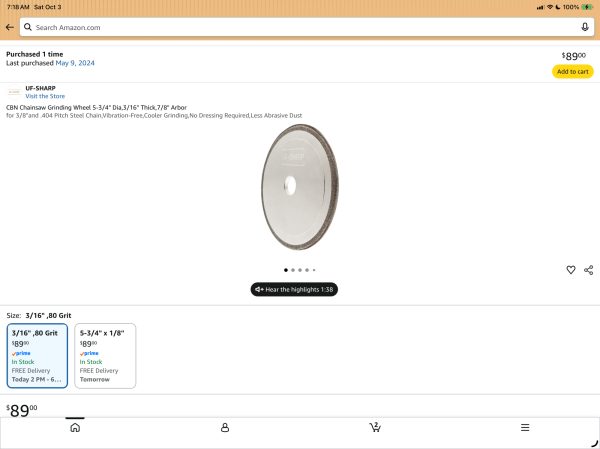

    I’m looking to finally start using my Oregon knockoff Timber Tuff chain sharpener. My main saws are a Stihl MS 170 (3/8P) and a Husky 445 (.325”), but I also recently got a hold of a Hart 20v (3/8LP).
    I know the stated file sizes of each chain pitch, but at quick glance, CBN wheels are seemingly either 1/8” or 3/16” and I’m curious how they match up to what I’m running.
    Any thoughts, advice, and experience will be appreciated!

    I use a 3/16" on my 3/8 pitch chain that I use a 7/32" file on. I'm no help on the smaller sizes, I'm sorry.
    One word of advice on CBN wheels though. The less expensive ones usually have steel bodies; the one you linked on Amazon does, too. The first one I bought was a less expensive steel one just like that one, and that thing is HEAVY compared to one with an aluminum disk.
    That extra weight may make the grinder's head sag down closer to your chain due to extra load on the spring; I don't know how sturdy the spring is on that particular machine. The other thing is that it takes much longer to spool up to speed than an aluminum wheel. I don't think it hurts anything unless you cycle your machine on and off repeatedly on short cycles; that may be hard on the capacitor. I tend to turn mine on and do all the teeth on one side of the chain before I turn it off, and I haven't had any problem with mine. Just pointing out a couple of the differences so you will be aware of them ahead of time.

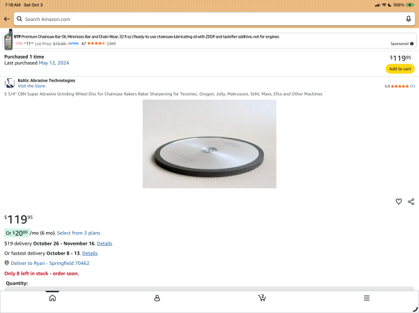

    Had this wheel for years. Best one I have ever used.
