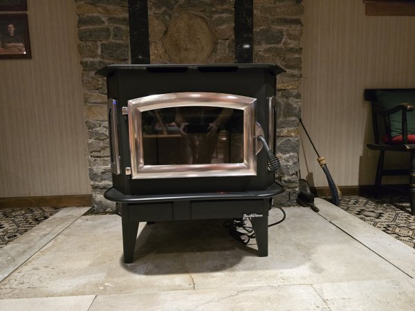

  6. Andyshine77
    Andyshine77
    Feb 8, 2014
    383
    1,955
    Cincinnati, OH
    Well I have an update. No stove yet and I just realized where Buck stoves are made. North Carolina right in the middle of the hurricane devastation. As of not Buck is closed for business. I will call my dealer later today and see what he has in stock. I may have to go with a different stove.
    blacktail, Pyromaniac and wildwest like this.
  7. Andyshine77
    Andyshine77
    Feb 8, 2014
    383
    1,955
    Cincinnati, OH
    Well somehow the Buck 81 showed up on Monday. Don't worry about the Hearth I'm going to replace that when I get a chance probably in a year or two when I have some spare change. I still need to pipe in in.
    Quick reminder 460-lb is a lot.:thumbs:
  8. Andyshine77
    Andyshine77
    Feb 8, 2014
    383
    1,955
    Cincinnati, OH

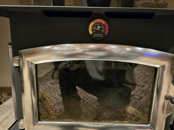

    Thought I'd go ahead and report back so far the stove is working really well and it heats the entire house comfortably.
    One question. I'm trying not to overheat this particular stove "I know I did with my old one". Where is the best location to place your surface thermometer at. I had it just on top of the stove and near the center when I get it rolling really good I've seen it up to about 500°F to 550°F
    Now for whatever reason I placed the thermometer just above the front door and it shot up to almost 800 real quick. Now obviously it's going to be hotter on the front, but should I regulate the temperature based off of the reading from the top of the stove or the front?
    Again I'm not new to burning wood, but I am new to not trying to overheat a wood stove and warp or crack it. My old stoves were cheapen almost disposable, this one not so much.
  9. brenndatomu
    25,352
    165,128
    I'd think you'd go off the hottest spot, but no idea on that model...
    Andyshine77 and wildwest like this.
  10. Locust Post
    8,970
    52,676
    On my Buck I have it on the side just under the lip toward the front.

    Much cooler on that location in my experience. The hottest location I found is right in the center above the door.

  12. Dunmyer mowing llc
    Dunmyer mowing llc
    Sep 26, 2023
    520
    3,424
    Indiana
    Andyshine77
    Being a non cat stove I would watch flue temps more than stovetop.

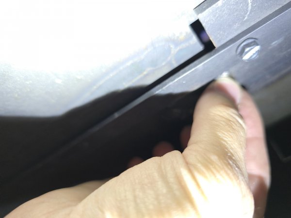

    Update.
    I made a slight modification to the stove. Something I noticed when I first got the stove, the damper has three main settings. High, medium and low. I have discovered the older 81's had a closed position.
    Here is a pic of the opening on the bottom of the stove, this is the maximum of the flu would close. There is a metal stopper plate that is welded to the stove to prevent it from closing fully.
    So I took my Dremel with the cutting wheel and trimmed off of that metal plate. It literally took like 2 minutes. It now closes fully. There is still a small open hole on the bottom of the stove to shoot some air onto the front lip of stove. Yes it's there by design, so even with the damper fully closed there will still be some small amount of air getting into the stove. This should make a big difference. I hope.

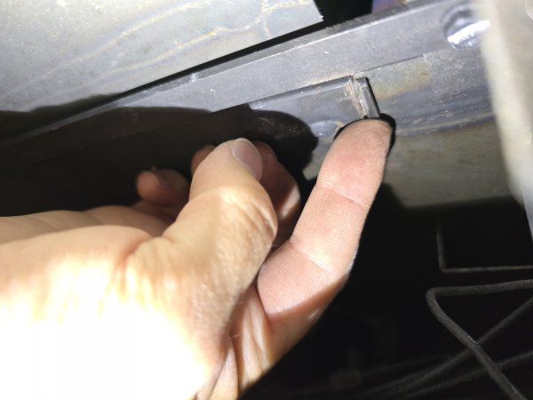

  20. Andyshine77
    Andyshine77
    Feb 8, 2014
    383
    1,955
    Cincinnati, OH
    Picture of the damper fully closed. And a picture of what I trimmed off. I believe this was all do to EPA regulations.
