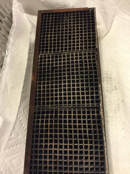

    For cleaning I'm thinking more along the line of residue to expose the catalytic elements again.....

    That cat is beat up looking! Mine isn't nearly that bad after 5 seasons. Glad you got your freebie!
    Backside of mine at the start of season 5.

    For sure it is not easy making those cats! That is why so few make them. I think there is another company looking at possibly making some but not certain.
    Steel cats seem to light off a bit quicker and are not as fragile. If you have fly ash, they will plug us a bit quicker as the cells are smaller. Still very easy to keep clean. But I think perhaps the ceramic gives a bit more heat than the steel does.

    The Steelcats are not sensitive to thermal shock or damage from air leaks which according to bk accounts for 95% of failures. I also expect longer life due to much more surface area so more precious metal.
    The bigger thing for me is earlier light off. Lower temperature and faster to glow active and make clear emissions. I have to burn totally stealth during burn bans and I prefer people have no idea that I even burn wood.
    Bk delivered stoves with both. Now, New models are steel only. They wouldn't spent the extra if there wasn't a reason.

    Just my experience regarding ceramic vs steel cats. I had a CDW in my family room for 25 years, that had a ceramic cat. The stove top had a built in temp probe just above the cat. "Engage cat when probe hit 500'F" was the directions. The cat was once of the Corning 6 inch round cats. Once a year I would take it out, which was very easy, tap it gently on a 2X6 to knock any loose ash out, and put it back in. Replaced it once in 25 years.
    Today I have a Fireview with a steel cat. It's okay, but after the first two seasons I noticed in season 3 that I wasn't hitting my higher stovetop temps that I did in the first two seasons, where my maintenance was lift the cat out, tap out the looser ash, then gently use a vacuum to pull any deeper ash/crud out of the cat. So I did the 50/50 water/vinegar thing with a spray bottle and that worked wonders.
    So from my perspective and experience so far, I'd rather a ceramic cat just based on the positive experience I had in the past with that old CDW and the Corning cat. I guess time will tell with the steel cats, because now I have two on them. One in the Fireview and the other in a Absolute Steel.

    I bought a steel cat from Condar last season, right away it was great. It lit fast and really put out good heat. But after 6 weeks it really took a dive, I cleaned it (lots of small fly ash) and it was back to normal. But it did it again not long after. So I called customer service and they were great. Gave me a ceramic and I have had no issues since. I much prefer the ceramic based on my experience.
    I know the wood I was burning was good, it was all top covered and seasoned at least two years. Might have just been my setup, wither way I was very happy to have the new cat and it run great ever since then.
