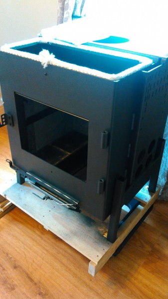

It's finally go time (next Wednesday) on the Ideal Steel that's been sitting in the dining room for a month. I'm not a huge data guy, but I am when it comes to temperatures.. Must be from spending my first career in the hamburger business. I'd like to go with a digital probe for the quick temperature reaction compared to the standard Condar unit many have used with great success. Particularly, it will be good to be able to "set and forget" as quickly as possible for both myself and Mrs Papi. Data logging would be great too so I can see what happens over night or while we're away, but if it's cost prohibitive we'll skip it for now. Money is pretty tight at the moment after some unexpected and large hits to the wallet. What is everyone using nowadays for a digital recorder or monitor? I have read through the IS omnibus, but a lot of the info is dated to a few years back, so some fresh reports would be very well appreciated! Edit to add a gratuitous pre install photo of aforementioned IS.
