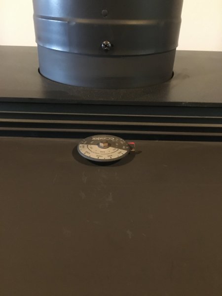

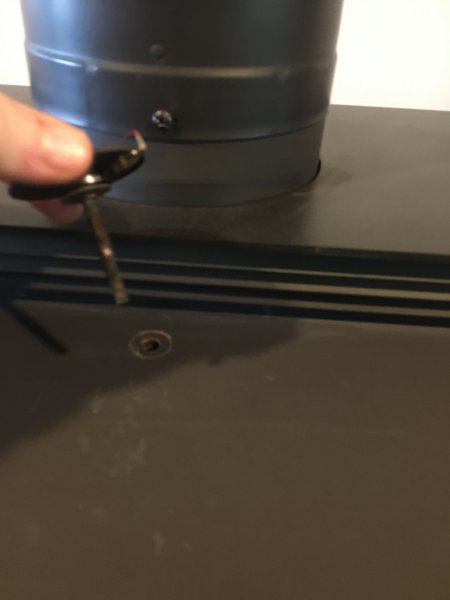

    How does the cat probe fit? Just flush on the stove top with probe inside? Our stove is here, it did not some with a cat probe or damper handle (or lid lifter, we did know it had one at the time). Husband went back and they gave them to him off a floor model, but husband keeps wondering if should sit on a washer or housing. Thanks

    Probe sits flush as delivered. Unmodified.

    Yes, I did get the ashpan option, but there order was not correct so we picked that up separately and returned the feet. Far out, NO, none of the above, it was still crated when my husband opened it, I handed him the plastic bag with the manual in it. No poker/ash plug hook (that's what I was calling the lid lifter), no cat thermostat probe and and no bypass handle.
    I bought a cast iron lid lifter for dutch ovens on a campfire, thus why I called it that. I know the real name now :) Thank you for saying it sits flush, that is what it looked like to me on pictures on the website.

    The meter just sits in the hole and the probe dangles down behind the catalyst. It’s currently 350 but I could hold it for a bit!

    The newest model princess might have a similar meter but with sort of a cup that surrounds the dial to block the wind from the blowers so it doesn’t change the reading.

    It's a BK4o if it matters, thermostat is directly in front of the chimney pipe and blowers are on either side. We can experiment with it without blower on and with blowers on.
