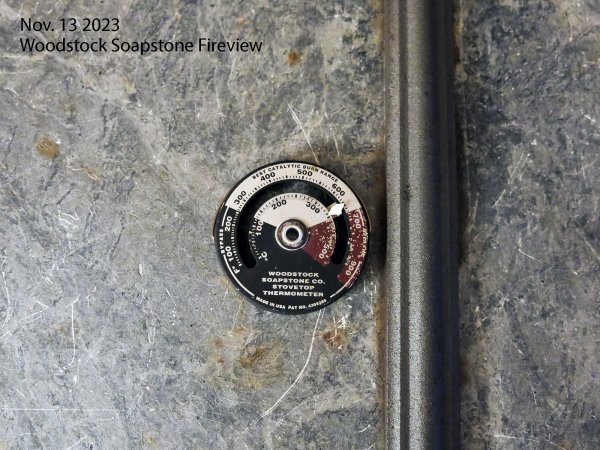

    Last night was pretty cold here on the NH/Mass border, so we had the Fireview going. The Fireview being a cat stove, here is a good example of maximizing the heat and minimizing the wood you're using.
    Wood burning in the stove. No flames, just a slow burn in the stove. Minimal heat in the flue.

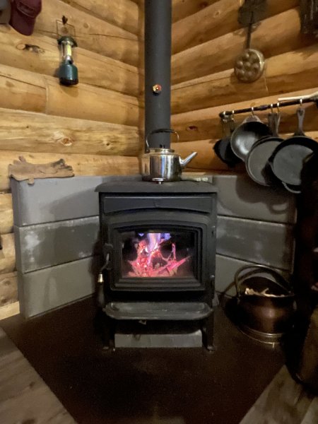

    And a non cat doing the same With a bit of flame.
    Highbeam and In the Pines like this.

    Those are two extremely different outcomes. The Fireview is burning at 650 on the stove top and a flue temp of 220. The stove pipe is essentially 1/3 of the stove top temp. The stove is heating the house and minimal heat is going up the stack.
    With the reburner stove the stove top temp and the pipe are basically the same.

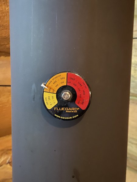

    His 220 flue temp is external mine is internal. Double his to get an approximate internal which would be similar to mine. Also the reason his stove top is at 650 is because the 1000 degree cat sits right under it. I’ve burned Woodstocks before the stove top temps are misleading. You can have a 700 degree stt with no flame but you can have an overall hotter stove with a little flame in the box and a much cooler stt.
    I believe flue temp is key here. The less heat up the stack with no smoke the better efficiency of the stove. Non cats seem to get a bad rap that they burn too hot, some do probably on purpose to pass the EPA test but there are some good non cats that have better control.

    The stove top temperature of the cat stove isn't really a good measure of output because it is sitting right on top of a 1000-1500 degree catalyst. It's a hot spot. Where on the the noncat, stove top temperature, is more representative of output. To put into context, whether the cat stove is at full chooch or just idling, that stove top temperature won't change much. The amount of the cat stove that is at that temperature changes.

    Yeah after running three different cat stoves I’m pretty impressed with this Jotul’s control. It’s not quite as controllable and have as low an output as my previous cats but it’s close enough for what I need. Once settled in the internal flue temps will hang around 100 degrees less than my stove top temps. If I get below about 375 flue I start to see a little smoke. 400-600 is where the flue runs, while stove top runs 500-700 from low to medium low air settings.

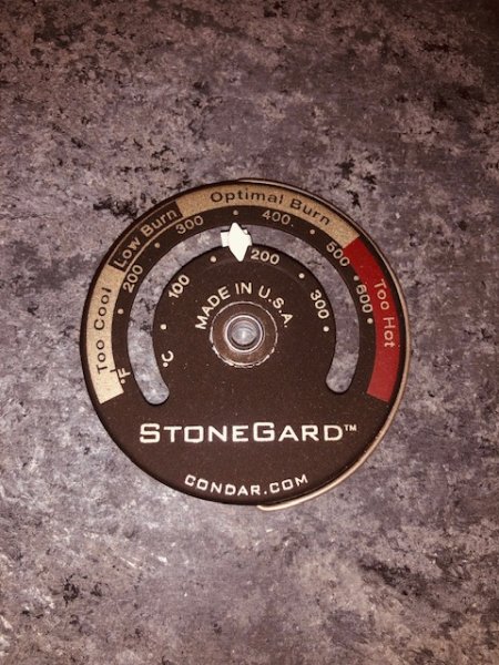

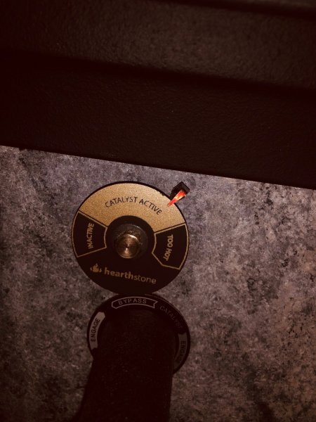

    Oldhippie, as a young hippie, I'm still learning how best to operate my stove. You'll recall I converted my wood burning fireplace, which is how I've always burned, to the stove back in January.
    So looking at your pics got me wondering. I thought soapstone was limited to 600*. Since your pic shows you above that, thought I'd probe to get your thoughts.... going that hot hasn't been a problem? Not worried about breaking a stone? And your cat doesn't get too hot???? And your thermometer shows 650* as overheat where my 'soapstone specific' thermometer shows 500*.
    I'd love to get my stove that high, but never have (intentionally) because I thought it was bad for the stove. Can I go that hot without damage? IMG_2137.jpg IMG_2138.jpg

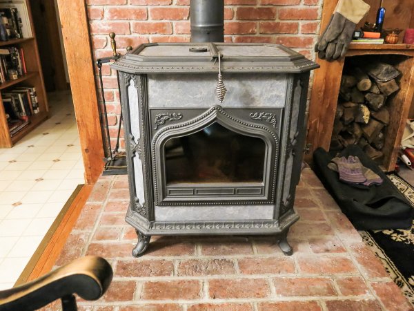

    I think this is a stove-to-stove question. The Fireview I have has a fairly large protective plate on the bottom of the top Soapstone, and above the cat. This protects the soapstone from taking the extreme heat of the cat.
    But I would give Hearthsone a call about that. Also, is there a way you can see the bottom(inside the stove) configuration above the cat? But even if not, call Hearthstone and get their input.

    I've spoken to Hearthstone and they weren't worried about 600*, though they didn't give me a number nor is there one listed in the manual.
    In the end, soapstone is soapstone, and if your guys' isn't breaking at 650*, guess I don't need to worry.
    But to confirm... when your stove top temperature is reading 650*, your catalyst temp isn't in the "too hot" range?

    You could probably buy 5 different thermometers and have a different schematic or painted on temp range on each of them. I have a cat stove and the thermo on mine has 700F in the "overfired" range but 650F is clearly within the "optimal" range. You're fine in my experience.
    I'm going to paraphrase a response I got from Dennis a couple years back imagining I'm remembering it correctly, but made a post worrying about my stove hitting 700+ and I think he said "eh, don't make a habit of it" or something thereabouts.
    Someone chime in if I'm way off.

    I don't have a probe type thermometer that can read the cat heat inside the stove. But I can look up and see the bright orange of the cat totally deep orange in color so it's really HOT. I have to look into what Highbeam mentioned about the 2 soapstone slabs with an air gap between them. I will look into that. I have heard to soapstone slabs cracking, but never heard why. But I have this stove on 700 or near it almost every burn. That's how nicely dried wood and a cat get along with each other.
