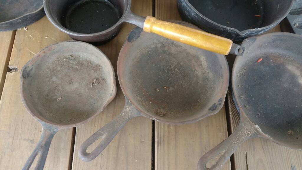

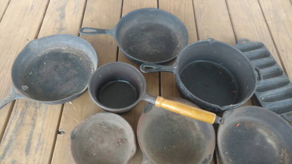

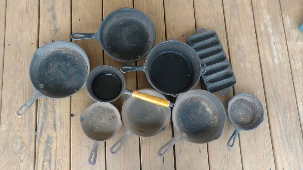

    I was at a house doing some work today and the home owner had these sitting outside. I asked them what they were doing with them and they said they were his great grandmother's/ grandmas and he was pitching them since they were junk and rusted up!!
    I tried to tell him they could be restored and he wanted nothing to do with it, ended up telling me to take them if I wanted to mess with them. He didn't have to tell me twice!!

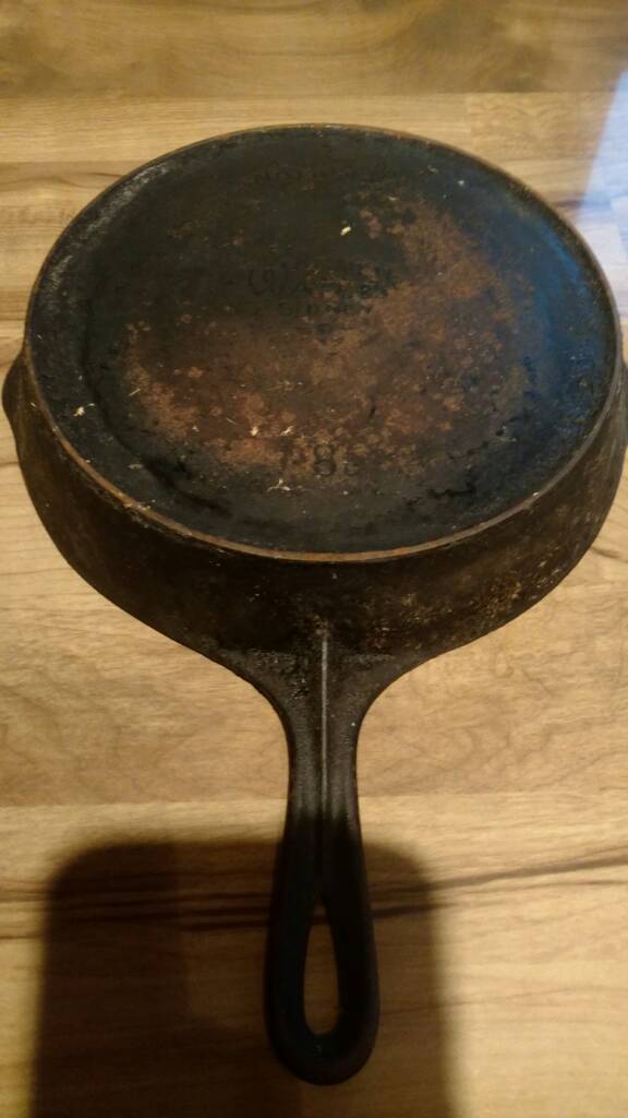

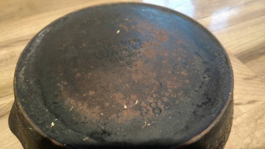

    This one intrigues me..... It's a Wagner 8 but it is super thin cast iron and has National stamped on it. I have a few Wagner's but non of them look like this.
    Sent from my XT1585 using Tapatalk
    blacksmith, Bert, NortheastAl and 5 others like this.

    That is a nice score! I just did a quick search and this was the economy line of Wagner. Still decent pans from what I read. I'm sure Dave can tell you a lot more. Nice additions.

    I was doing some research also and found the same thing. 4 of the other ones are Wagner's and are much thicker. A few of them I am going to have to clean up to tell what they are. I am.now officially a cast iron hoarder. I already had to many and now I am going to have to move some to storage lol.

    Wow!!! What a cash! :eek::cool:! If you want to see how nice they'll clean up, Get a big tub/container and throw some warm/hot "light soap" and water, wash one at a time, rinse, and as soon as they come out dry them quickly so you don't loose any patina and create rust. Spray them with pam and go from there. The National is a "fine" pan!!! It was like a grocery store pan and was sold in many different stores, Quite old! I see you got a #8 deep chicken cooker in the mix! Excellent for the fried chicken and veal dishes. I do baked beans in mine. "VERY NICE"! Lucky dog! :cool::dex:

    Thanks for the info! I will probably be on here asking for some cleanup advice. Some of them have been used so much that the grease on the sides and bottom is thick, really hard, and almost crystallized so what would you do with that?
    I started cleaning up one of the smaller skillets and now you can see the numbers on the bottom of it.

    To bad that guy didn't know what he had! That looks like an awesome cast iron set. You make me jealous!
