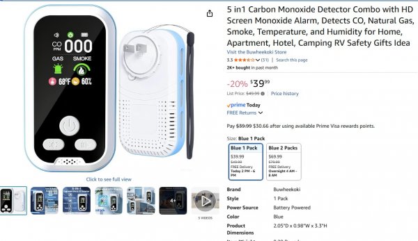

    That is kinda handy I just checked and canceled the one and found one that did. I actually ordered two, one plug in which I am going to put in the same room as the stove (I swear I had one in that room, I will be good $, my wife moved it to vacuum, lol) it's a 5 in 1.

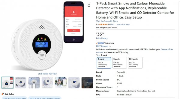

    Sure thing, these are two I picked up. The plug in one already came LN and was put to use, I love being able to visibly see PPM readings...............errr more on that in a moment!!!
    Other ceiling mount has an app where I can see historical data as well as PPM reading on the face of it.
    I was able to score that plug in one for $14.99 yesterday on a lighting limited deal, now it's $40, ugh!
    Plug In
    Ceiling Mount
