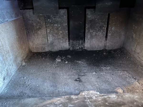

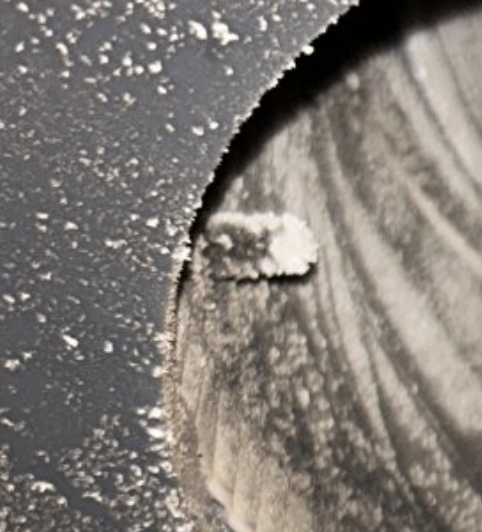

    I do, I usually remove the secondary pipes along with the baffle then head up to the roof and clean top down and the soot just piles up in the FB.
    Now knowing my soot eater isn't reaching I am going to try and clean bottom up asap make sure there is no blockage and see how much soot I get.
    If I don't get much I'll be at a loss again! Hail Mary would be replacing the gasket (I ordered the correct size) and if need be look into an OAK kit, but with my setup that seems like it's going to be extremely difficult hoping it don't come to that and the reason why this is happening become evident.
    Thanks again all!

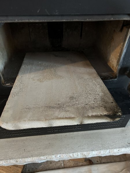

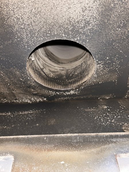

    I stand corrected I have 8 3ft rods giving me a total of 24ft of pipe + the head.
    So needless to say I cleaned it out this AM before work and nothing...........very very little soot if any.
    I took a peek at everything inside since I decided not to run the stove overnight LN, and all looked ok from what I can see.
    Forgot to do the dollar bill test :headbang: while the stove wasn't running but I am 99% sure that sucker is so dam tight.

    Same!! Back to square one!
    Ran it last night overnight and it ran flawlessly, I don't get it.
    I will say the air intake pic I shared prior was after I cleaned it a bit, all those mesh intakes were caked with pet hair, that could be a contributing factor.
    I am still putting money on the door gasket I think something is up with it. I haven't be sealing it as tightly, it's tight and secure enough trust me but if you latch it all the way it's like a coffin.

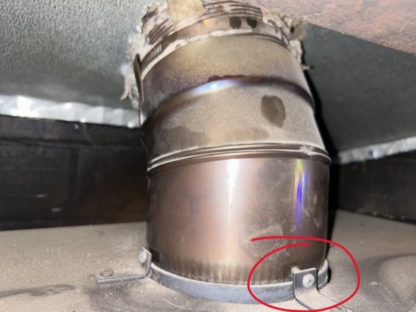

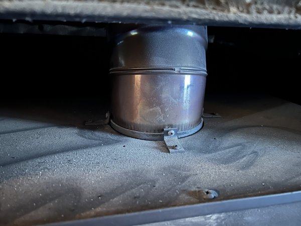

    This seems like a longshot- but is there any chance that at the terminus of your stack, your stove is somehow drawing the exhausted CO back down the chimney? I can't tell exactly from the pictures but in one of them it looks like there's a gap around the liner and the collar it's in. You would know your system better than me what I'm looking at, but if you had to pull up the liner a bit to get it to fit better in the cap- is there any way possible that little bit of slack you pulled out opened up a straighter shot for the exhausted fumes to make their way back down the stack and into the house?
    I know I'm Cpt. Hypothetical over here, but I'm trying to think of something that hasn't been said yet.

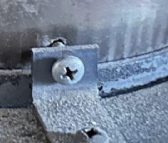

    One more while I'm at it... I zoomed in as much as I could on a couple of photos. When these screws were put in, and maybe over the course of a few years taken out / put back in- do they pierce through the liner? Could you be getting any CO into the room through there?

    So that collar has been like that from installation. It looks like it's not seated all the way. I remember Eric VW mentioning that as possible concern.
    With that said it's definitely possible it came a bit loose while trying to re-secure my liner for sure as I did pull up on it. I can check that a bit again make sure there is no gap between it and the top of the stove opening. I can also check those screws maybe this weekend as it's suppose to hit 60 degrees around here what the hec!!!!
    Collar thing always bothered me as you can see the taper sticking out but it will not go any further into the top of the stove (unless it's suppose to go down into the stove??). I tried and tried and it just is hitting the top opening of the stove.
    Would using some high temp caulk be a bad idea around that throat area to possibly seal up any leaks?
    So the liner goes into the collar and secured at the top of the collar from my recollection it will not go all the way down into the collar, there is lip at the top preventing it and fastened at that point.

    I did check the collar this AM as well and took another pic. The two screws on the side are tight as can be. The one circled is loose and just spins when tightening it. I need to get a longer screw. I didn't get a chance to get in deep enough to check the liner to collar as that is where it might have loosened when re-adjusting the liner.
