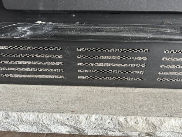

    • The below pic was after I started cleaning it, it was dirty and the mesh vents were covered pretty bad. Could this be playing a role?

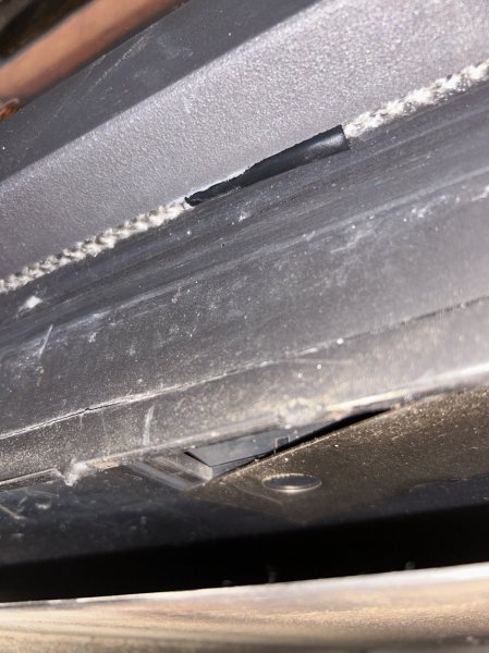

    • brenndatomu I assume your taking about the air intake? Below are few crappy pics of it, yet it indeed has a hole in it.

    No, that's the blower inlet, which while a little dirty, is far from plugged (how do the blower cages look though...those usually need to be cleaned every year, or they get out of balance, making an annoying rattle!
    (Well, the second pic does appear to be of the stove air control)
    The issue with a "too large" or "wrong density" door gasket is that if it is too thick the door can't lay flat against the stove body...it will come hard against on the hinge side and then not be able to pull down tight (sealed) on the latch side.
    You could give it the dollar bill test, especially on the latch side...if you latch a bill between the gasket and the stove body, it should not pull out easily (you normally do multiple tests, the whole way around the door)
  17. moresnow
